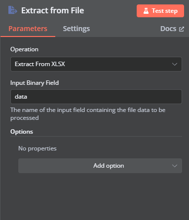

You could pull the whole file. Though you would rather convert its content to JSON with Extract from file node.

The question is how do I access that file or the converted data in the python module then and how would I export it to the same/ or a new file again.
Screenshot 2024-12-05 115226
To convert processed data to file use the node Convert to File.
Here’s a rough example if you are still struggling to understand.
Having said that you might rather want already created files updated. Then there is no need to convert the data to file. Just update the data in those files without downloading them (only pulling the data first to have them updated in n8n).
Hi,
thanks for the illustration. I get your core idea but the main problem is how to access the file/data in the actual code. The input and output within python is the core problem
I’m not following your problem. When you pull the data from Google Sheet of Excel file you have plain data in JSON format with each item representing a row (similarly to the data output you see in “Data from Sheet” node in my example workflow). The Code node already showed you how to work with that data.
