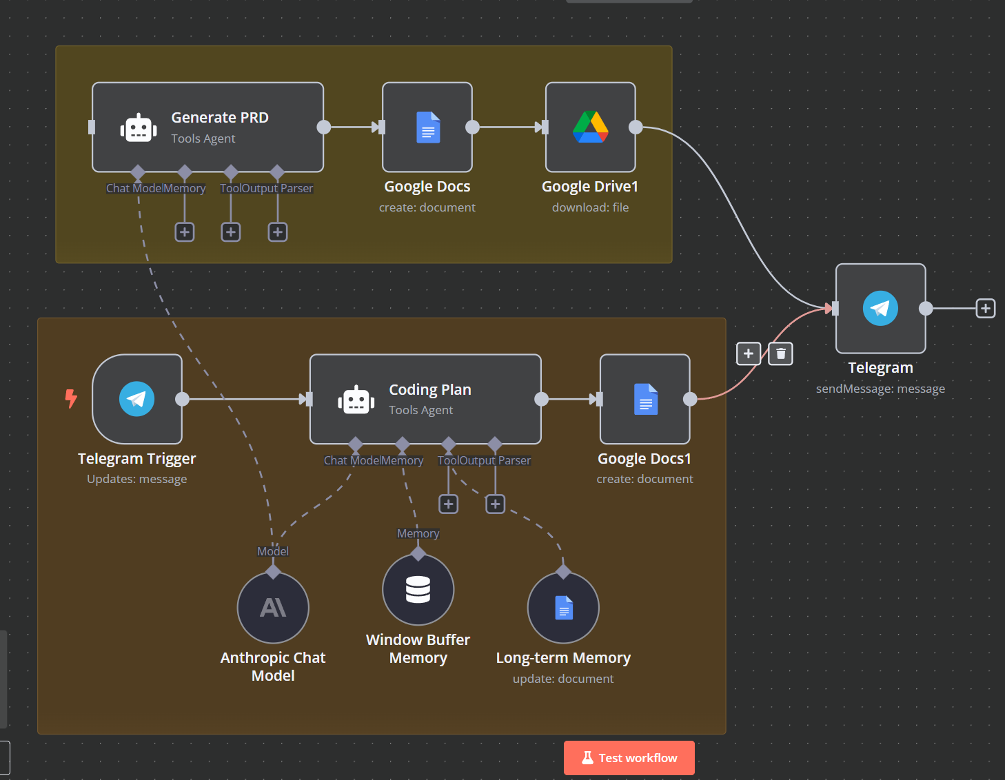

  2. Filling Google Docs Content from Telegram:
    I’m also exploring whether it’s possible to fill Google Docs content based on user interactions in Telegram. Here’s the context:
  • I’m building an AI agent to assist in coding.
  • The AI agent interacts with users via Telegram, asking questions about the project (e.g., requirements, details, etc.).
  • The output of this process should be two Google Docs: a PRD (Product Requirements Document) and a Cursor AI Coding Plan.
  • These docs need to be sent back to Telegram once completed.
Is this achievable with n8n? If so, could someone share insights or examples on how to set this up?

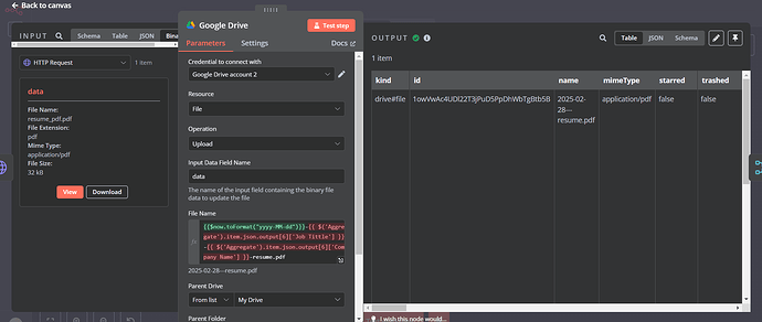

Retrieving Google Docs ID
After uploading a document to Google Drive using n8n, you can easily obtain the document ID:
  1. In the Google Drive node output, look for the id field.
  2. This id is a unique identifier for the document in Google Drive.
  3. Example: 1a2b3c4d5e6f7g8h9i0j1k2l3m4n5o6p7
You can access this ID using an expression like:
text sample here paste it as expression:
{{$node["Google Drive"].json["id"]}}
Updating Google Docs Content
Updating the content of an existing Google Doc is challenging through the standard Google Drive node. Here’s a workaround:
  1. Use the “Write File” operation to modify the content locally.
  2. Upload the modified file to Google Drive as a new document.
Note: This method creates a new file rather than updating the existing one. You can update some metadata (like name) of the original file, but modifying its content directly is not straightforward with the current n8n Google Drive node.
Alternative Approach:
For more direct content updates, consider using the Google Docs API through an HTTP Request node. This requires additional setup but allows for in-place document editing.
