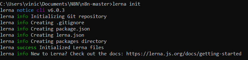

4° - I entered the root folder and used the command lerna init
5° - Then I ran the command lerna bootstrap
After the 5th step I tried to run the command npm run build, but it didn’t work. What should I do?
