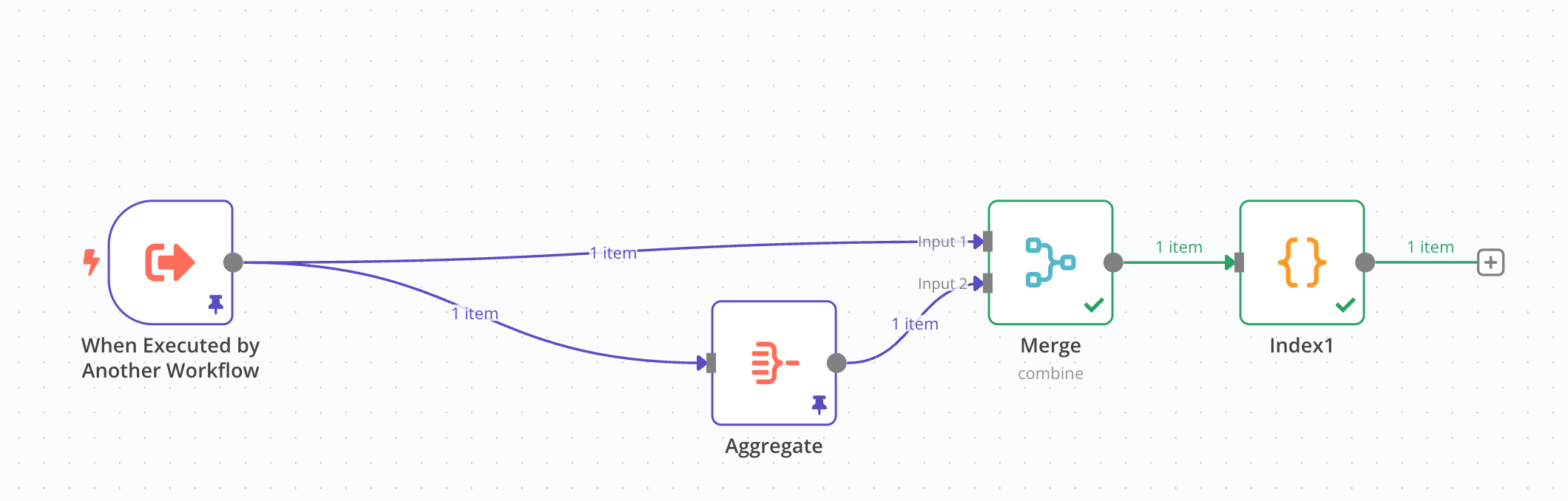

How to save and access pinned data in automated execution? (See screenshot)
So when i run this as manual execution, it’s working. When i want to run a automated execution, the pinned data (of the aggregate node) is not recocnized.
How can i acces this pinned data in an automated execution?
Are there any nodes, where i can save it? I did try with a set node, where i did enter it as JSON, but when i ran it, there where alway 2 item coming out of the set node - and it should be only one.
(JSON is 3mb)
This is an expected behavior. You may use Set or Code node to “freeze” (substitute) data on production.

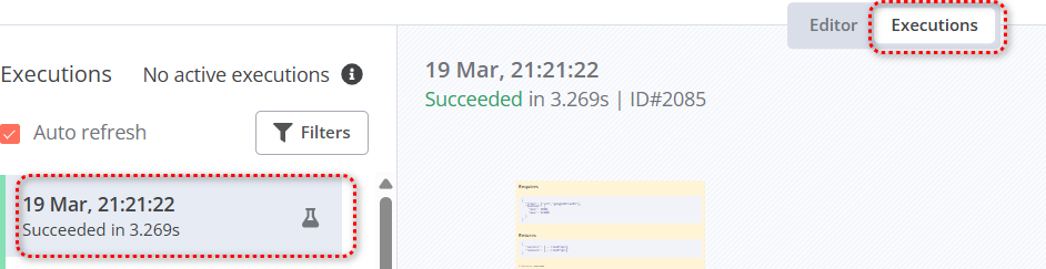

You could look into the actual data from the execution in Executions tab.
It is very handy in debugging process.
Hard to tell without seeing the actual workflow (I mean the workflow per se, not a screenshot of). Try posting the workflow using </> button and maybe pinning some data in the nodes.
Maybe you have two items at the ingress of Set node therefore it is executed twice.

Hi @Olek . Thanks for the answer. I did try with the Set node & function node, but with my limited skills, i did not manage to make it work. Here’s the workflow:

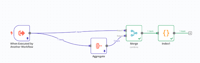

Also, this fragment will give you a single item as the output. You mentioned you received two items in the output when only one was expected. Is it something that happens in the main workflow that calls the sub-workflow you quoted? Could you post the relevant fragment from the calling workflow?

If you wanted to “pin” the data in production currently actually pinned to Aggregate node, the following would be an equivalent replacement that will work in production:
Is this even close to what you are trying to achieve?
That was it. Wow i can’t believe, that ChatGPT, couldn’t write this, even after 50 different tries. Thx alot!
