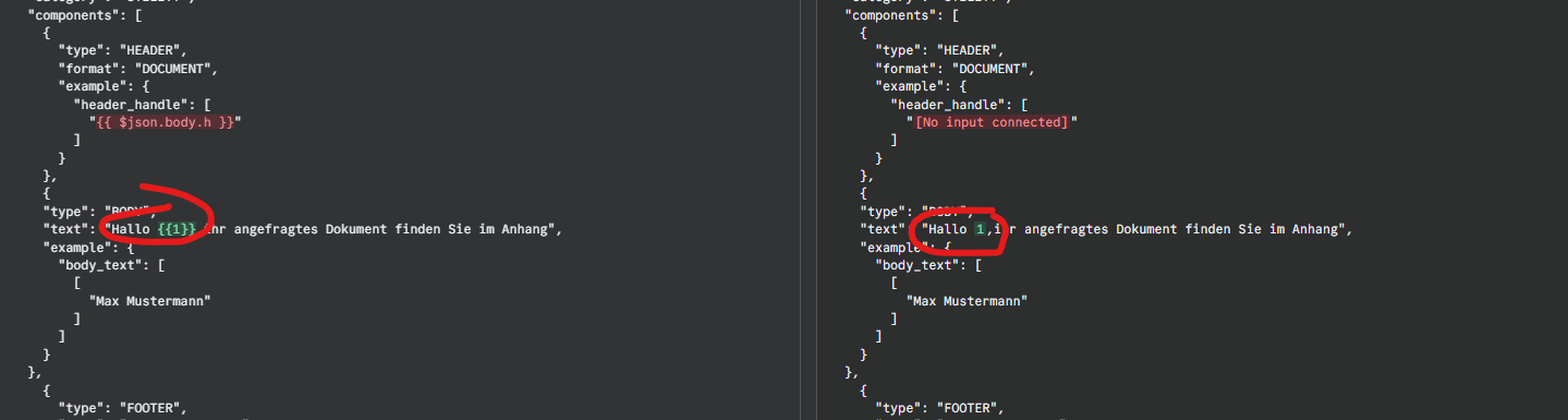

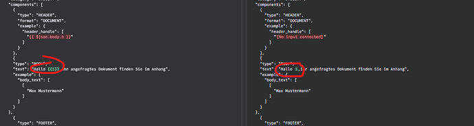

I’m using the HTTP node to send a JSON body with a static placeholder {{1}} to send requests to the Whatsapp Business API. Here’s a sample:
"message": "Hello {{1}}",
"dynamic": "{{ $json.data.value }}"
When I set the Body to “Expression,” {{1}} becomes 1, but I need it sent as ‘{{1}}’ as the template expects variables to be defined like that. When I set it to Fixed this would work obviously but then all the other values cant be mapped any longer. Problem is also that I am generating the json structure dynamically which means I cant use the “Use Input Fields” and then only set that part to Fixed as the total number of input fields is not fixed.
Does anyone know how to solve this?
