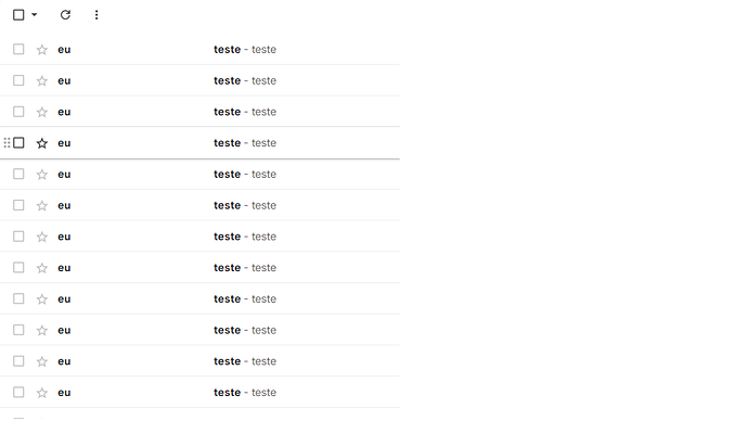

in the last image i get multiple emails and no attachments, how do i get only one email and the attachments?
in this example there are 23 xml files
So, there’s two different problems here. One would be your Attachments field. This seems to use an expression resolving to xml. However, your binary items are named data here:
Once you remove the expression from the Attachments field of your Send Email node and simply enter data here you should get emails including your attachments.
Perhaps you can give this a go in the first step?
This will still result in multiple emails (albeit with an attachment) and this is because most n8n nodes will run once for each input item. So, if you pass on 23 items to the Send Email node you’ll send out 23 emails. Meaning you would have to first merge your items into a single item before running your email node to avoid this behaviour. Here’s an example workflow doing this:
