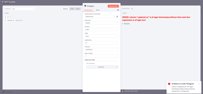

I’d like to update a Postgres row with the current time after a step has been completed, but I am having trouble passing the date in as a valid attribute for an item.
In a “Function Item” node, if I set a date field using something like this, either as a date object or a string:
item.updated_at = new Date();
or
item.updated_at = new Date().toISOString()
Then in the “Postgres” node, I do an update on my table, then I get a standard Postgres error back that the type of updated_at is a string, not a timestamp.
How do you correctly transform/represent a date attribute of an item in an update in the Postgres node?

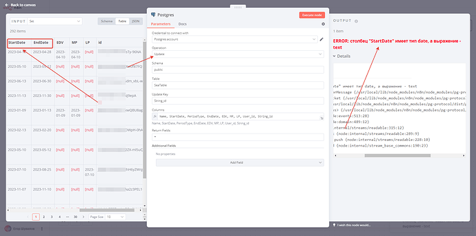

Good afternoon! I have the same problem. When updating data in postgresql, an error occurs. When I do adding data everything goes well. The error appears when updating. I use a standard Postgresql node.

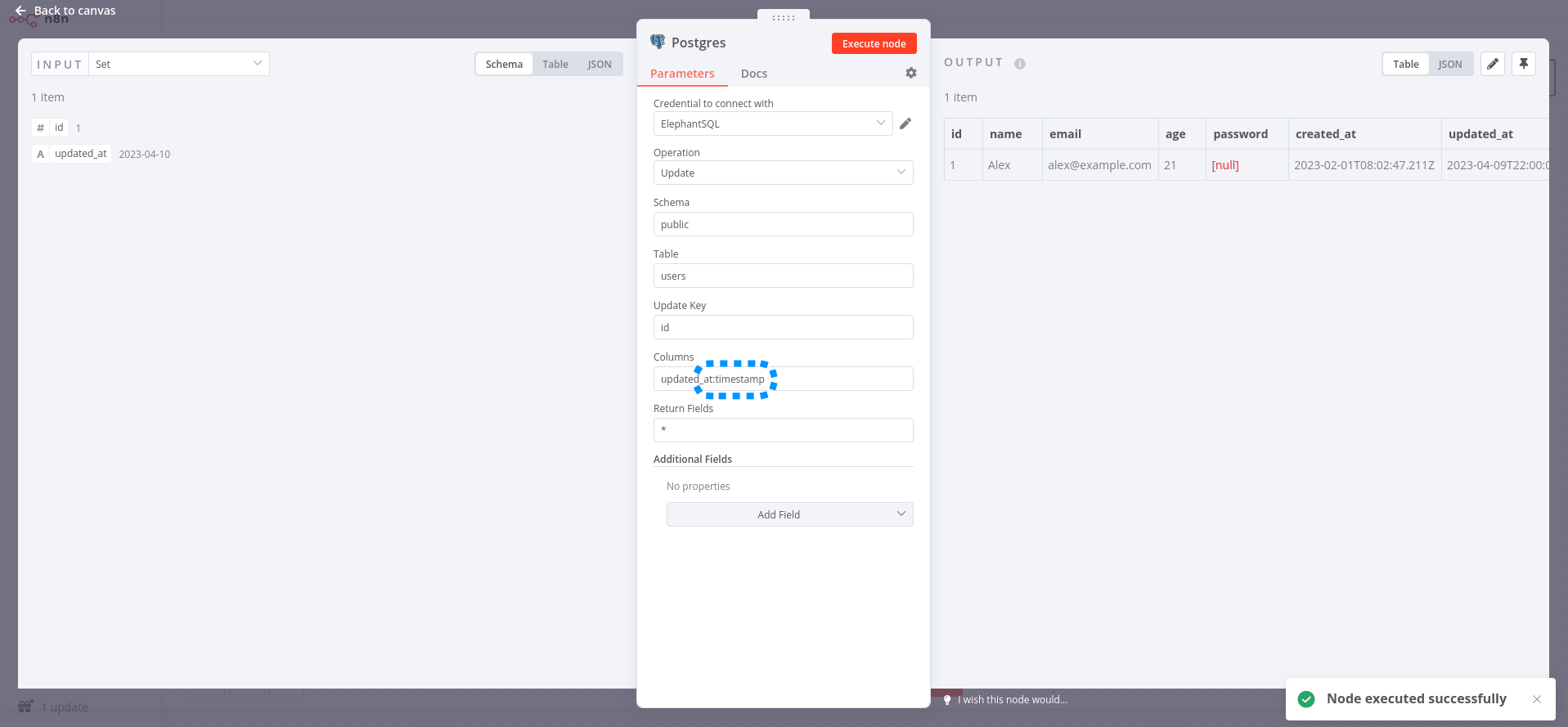

Can you try specifying your timestamp column like StartDate:timestamp (replacing timestamp with the correct type in your database)? This would let you use type casting through the Update operation of the node.
Here’s a quick example from my own database without :timestamp:
When appending :timestamp to the column name in questions this operation works:
I hope this helps!

Thank you very much, your solution works!
