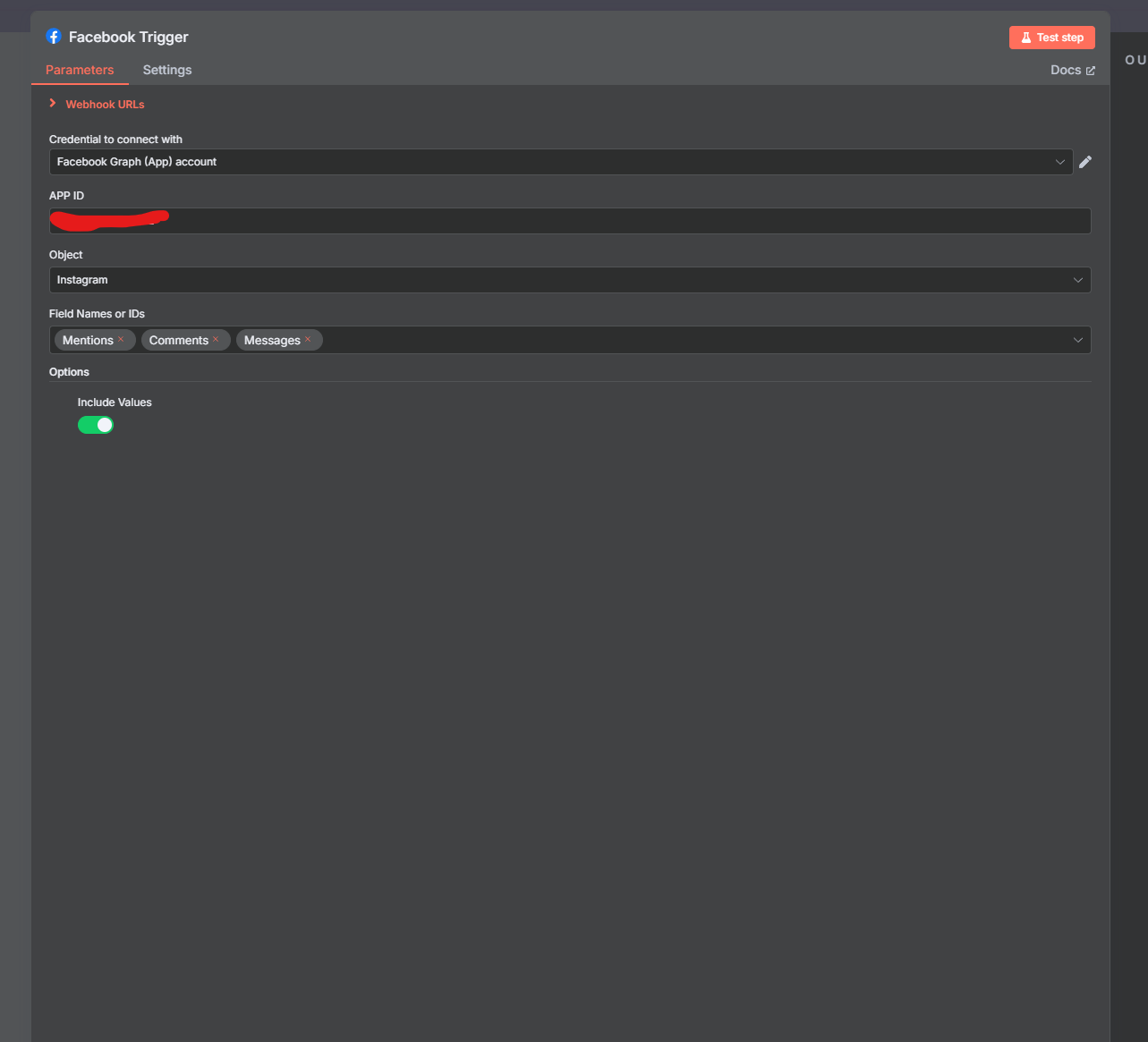

Now my confusion is as follows, n8n facebook trigger requires the following:
App ID
App Secret
Access Token
Now which access token and which app ID do I use?? I tired all different combinations and nothing is working.

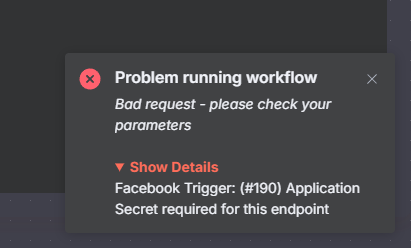

The error I get is this:
Facebook Trigger: (#190) Application Secret required for this endpoint

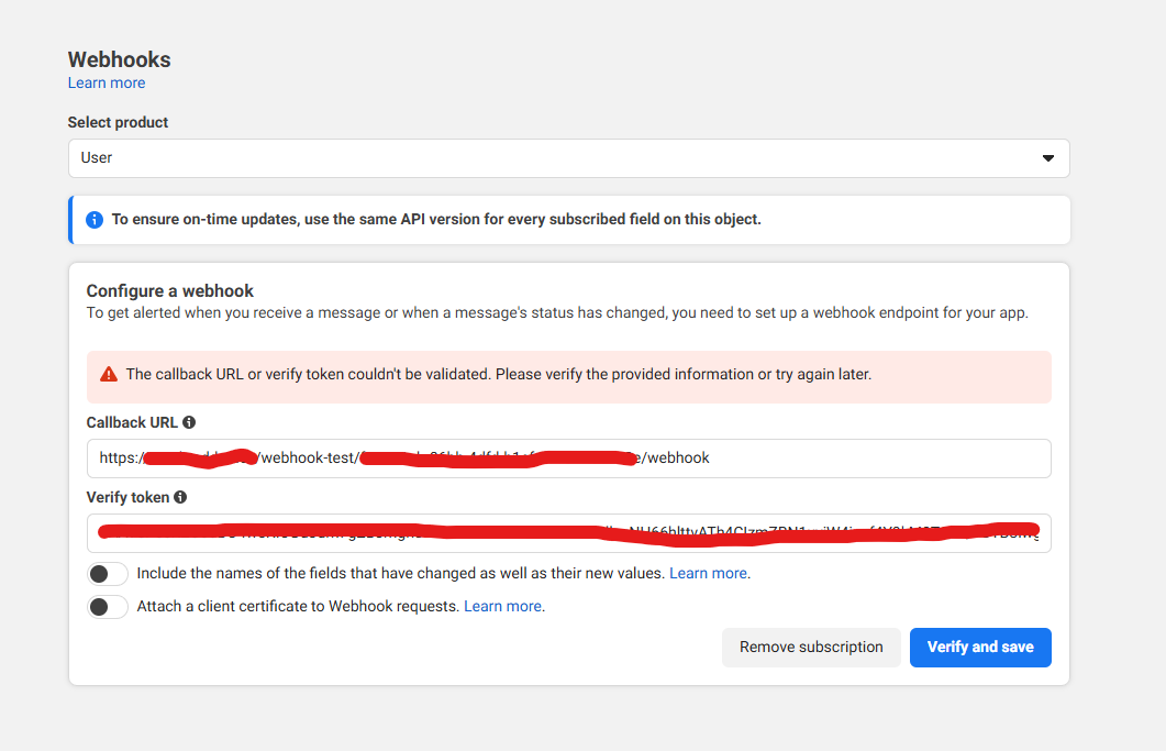

  • Step 13/14 in “Creating Meta App” - It requires me to create a webhook but doesnt guide me on how to do so, it requests a “verify token” but doesnt tell me which one to use. Also for the instagram integration, the instagram app already has webhook in that app so realistically I should be settings it up there. but again No documentation on how to do this.
    When attempting to add the n8n webhook, it fails to call it because the webhook is not active… which I cant active until I get the hook to work… you see the flaw in this step?

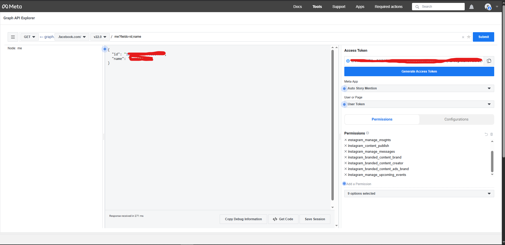

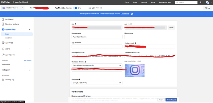

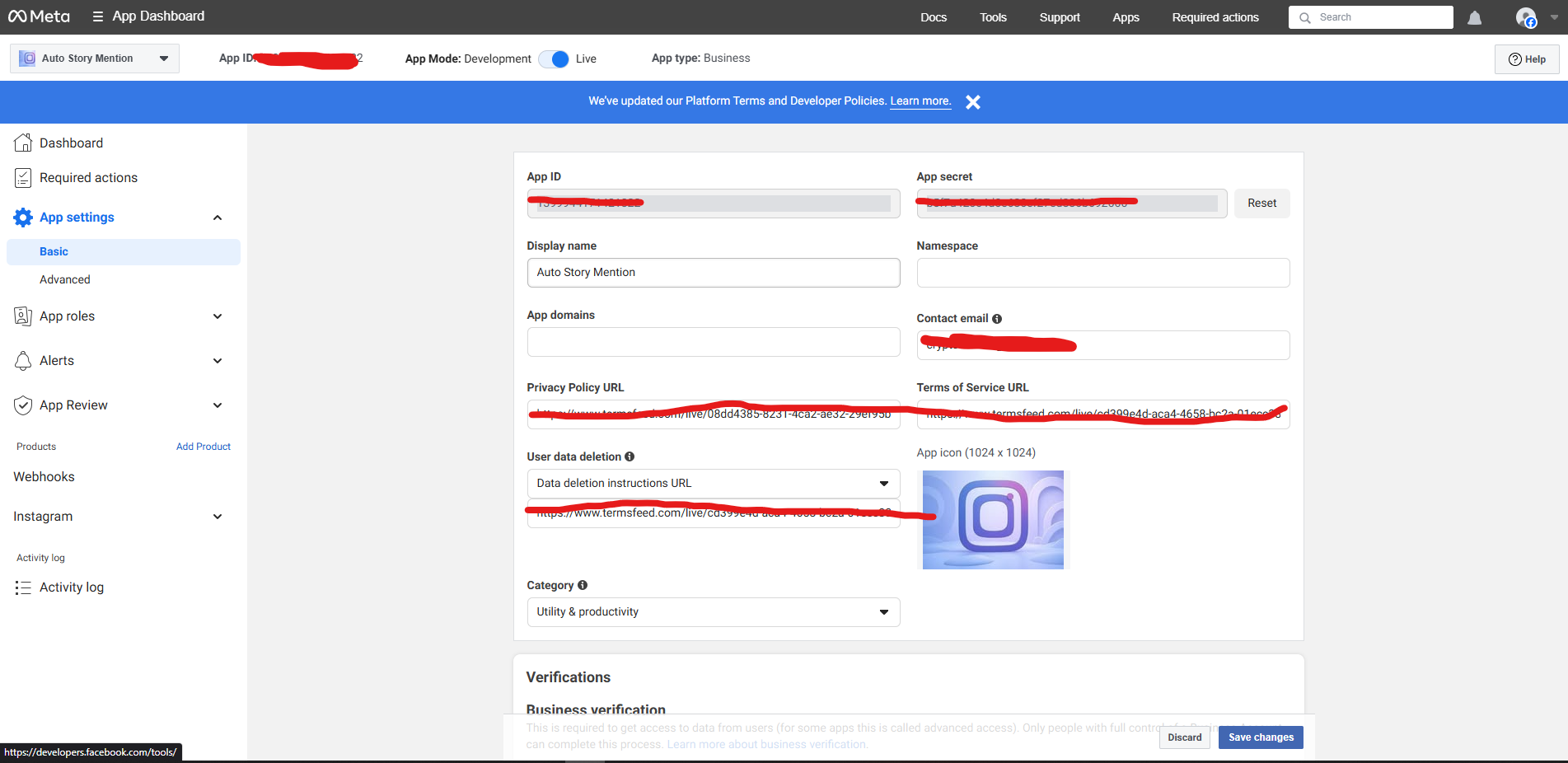

here is where I have gathered all my values so you know that I am using the values that the DOCS has requested.
Access Token
App Id + App Secret
Error Message:

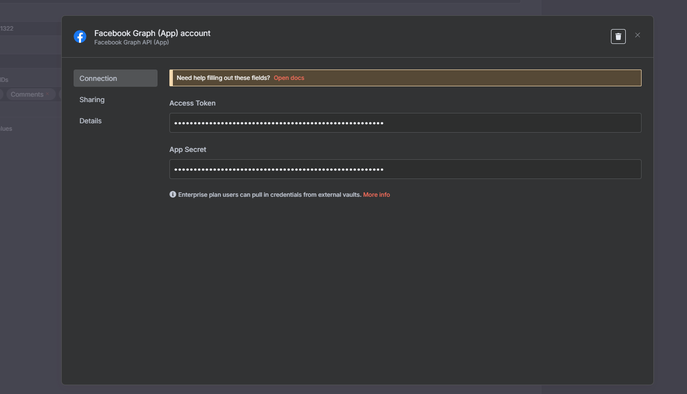

Can you show me your n8n connections for these (with PIIs removed)? The error indicates you put in the secret wrong or similar.
Hi,
I am only using facebook trigger, nothing else is connected to it and my other workflows are non-related to this.

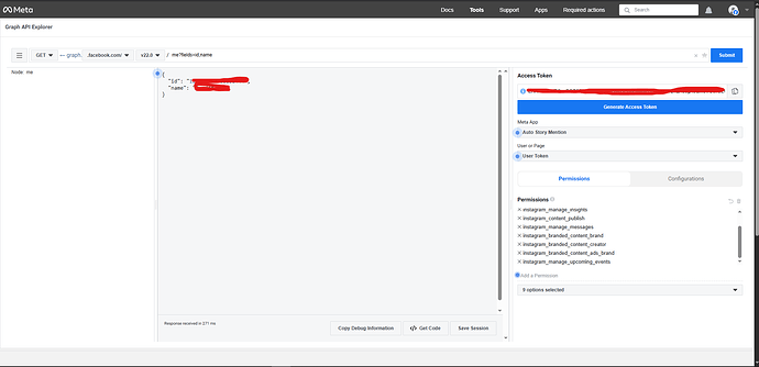

I have used the access token from the graph API as shown in the previous image
I have used the app secret from the previous image as well
and the app id as well.
All match up to what I got in the n8n configuration.

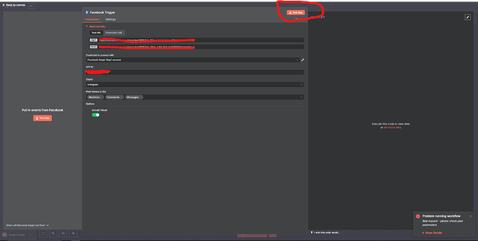

Then testing the trigger gives this

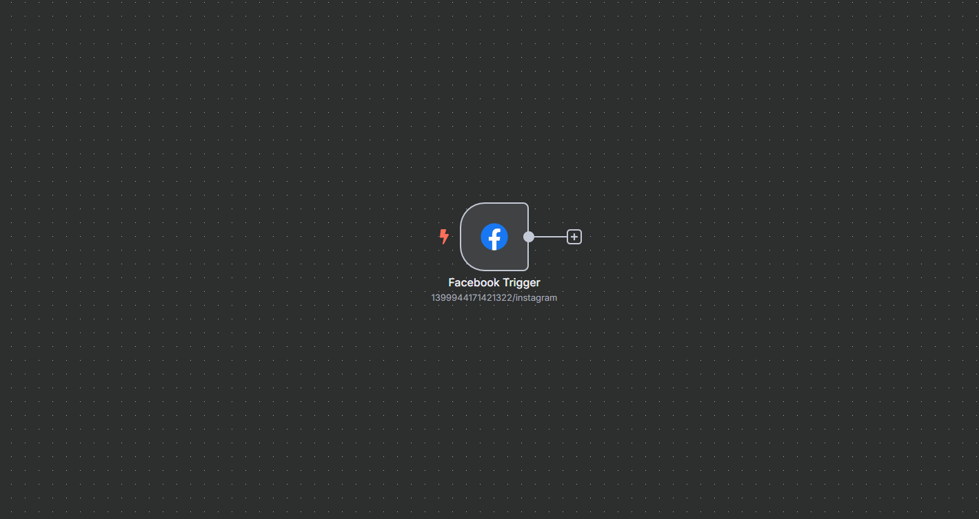

this is the entire workflow

  1. Copy the Webhook URL from n8n and enter it as the Callback URL in your Meta App.
I cant do this step if the trigger is not active bro…
the websocket needs to be active from my side so it can verify it…
incase you mention about the product not matching, I tried using just instagram too but does not work…
You open the trigger node and click the “test trigger/node” button on the left and let it run while adding the test webhook.
that doesnt work because it cant authenticate…
I tried activating this many different ways, non of them work.
if you gonna say to click test and verify at the same time, that wont work because I get that error on n8n INSTANTLY
The issue must be related the credential setup then, have you tried/double checked it has the correct values?
Yes, they are exactly the ones specified.
which brings me exactly to what I said in my original post, the docs does not point to the correct credential setup.
