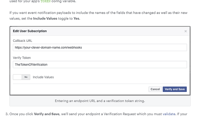

@Anand_C Yes add that permission as well. I also see what happened I think. It is in your first flow that is the problem. At 2:45 of your video you added the Page Access Token instead of “MakeUpATokenHere” under “Verify token”. This may be causing it. You only need to make up a token and NOT use the Facebook Page Access token here…I know it is a little confusing. Try making up a token there and then go back to the Facebook Lead ads testing tool and seeing if the app ID is subscribed to the webhook for leadgen now. That is definitely the problem I think.

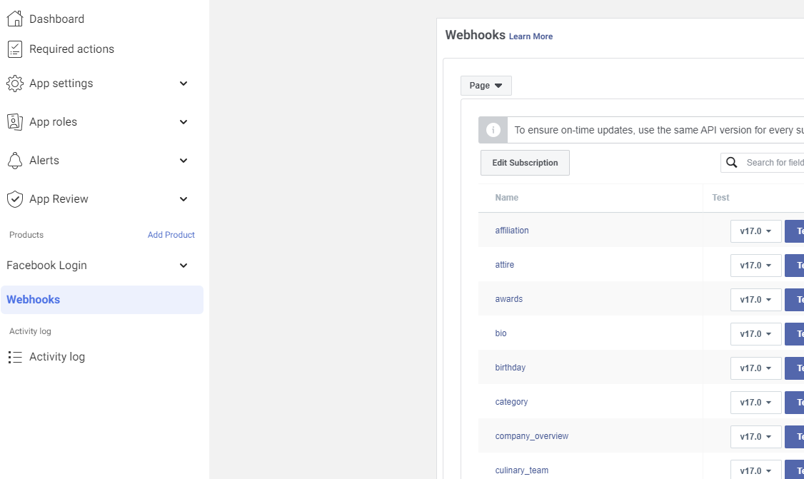

I have noticed that if you get any error Facebook will remove the app ID and leadgen permission and the next time you go in, it will be gone. I had to do this a few times before I finally got it to stick, and I forget what caused it. Now every time I click into Webhooks in the app…I see this screen:
and you are not seeing that- yours is looking like its not subscribed at all because its removing the subscription.
Do you mean I have to type in “MakeUpATokenHere” instead of the Page Acess token inside the Verify token?
@Anand_C yes, try using a made up token there like he does here:
and double check that Respond to Webhook confirm hub.challenge is set to:
respond with Text and {{ $json.query[‘hub.challenge’] }}

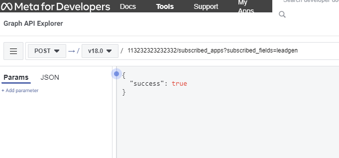

@Anand_C I’m pretty sure I know now why you can’t see the app. In these directions from Facebook it says: To get your Page to install the app, have your app send a POST request to the Page’s subscribed_apps edge using the Page’s acccess token. I’m sorry I left that part out in my directions as I did it once and didn’t realize that it was necessary as well. It is a one time thing I think unless it errors and deletes itself.
You will then see the app id in the Lead Ads Testing Tool
Here’s how to do it in Graph Explorer:
Make sure it is set to POST, then send this with the Page Access Token in the field to the right and you will get a “success”:true:

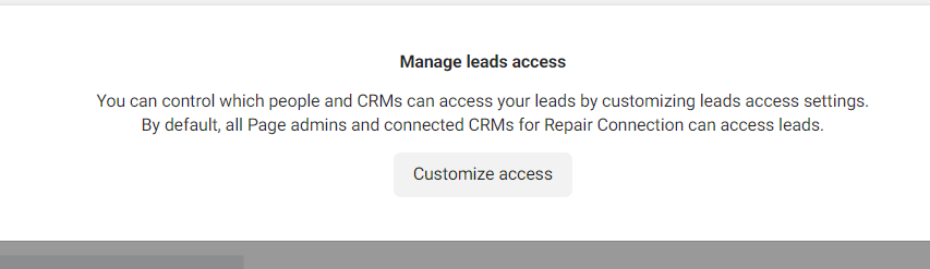

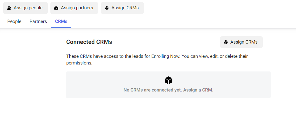

Now you should be able to see the appid subscribed in the Lead Ads Testing tool. Sometimes it will delete itself out of there if you have an error so check your Executions in n8n if thats the case. Set your app to live with privacy and terms and you may also need to do it with a verified Business Manager now (not sure). I also go into here in Facebook Lead Access and click into the Page and choose Customize access:
I then can choose Assign CRMs and choose the Facebook app name, and it should show up only after you do the previous steps:

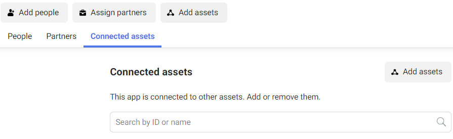

You also want to go into Facebook Apps here and choose the app you’ve made for this, and add the Facebook ads account to the app by choosing Add Assets here:

side note: I used 113232323232332 in the POST request as an example- you really want to use the Facebook page ID there.
@kenna wow that was it, that’s what we were missing. Finally, now I can switch from Zapier to n8n Thank you again @kenna, and thanks to the n8n team.
