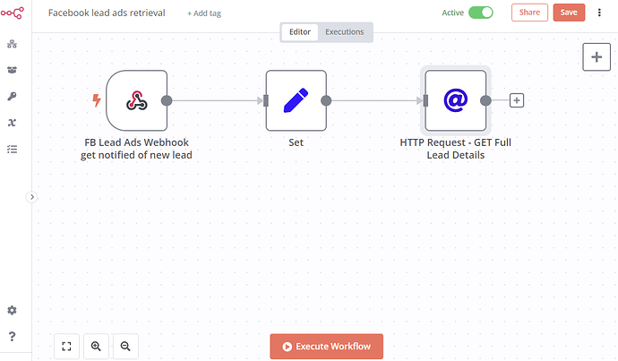

Part 2:
Once you have that setup in n8n you can now go back into Facebook and subscribe the Webhook URL (I used the production n8n URL). Select Page in the Facebook Webhooks area and enter your GET Url. Here is the area for Facebook to subscribe the Webhook to “leadgen” and you just need to scroll down and you should be able to hit Subscribe next to “leadgen” once you set this Callback URL and Verify token:
You should now get a confirmation in the first “FB Lead Ads Webhook Verify & set leadgen” workflow. Keep this workflow active and make the second workflow with the same URL to receive the POST lead notification Webhook from Facebook. Here’s what my second flow looks like:
Inside the webhook it looks like this (note: I am using the same URL I renamed yourn8n for this tutorial - it is just set to POST in this flow):
Inside of the Set node is Keep Only Set and leadgenId set to an expression of {{$json.body.entry[0].changes[0].value.leadgen_id}}:
From here we can now use an HTTP Request node to get the full Facebook Lead Ad and send it to a Google Sheet or whatever we want. Inside of my HTTP Request - GET Full Lead Details I have method set to GET and URL set to an expression of https://graph.facebook.com/v17.0/{{$json.leadgenId}} I also have Send Query Parameters set to Using Fields Below with Name of access_token, and Value of EAAJPUTYOURFBPAGEACCESSTOKENHERE as shown here:
you just need to put your Facebook Page Access Token in for the sample Value I entered.
and that’s it! You can then connect this last node to all of the awesome ways n8n has to distribute the data. Thank you to n8n!
