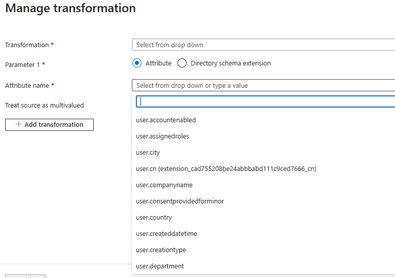

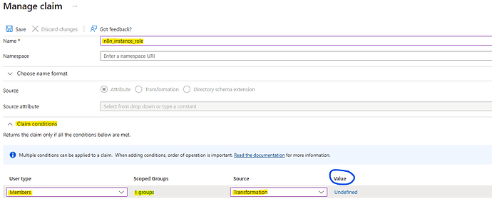

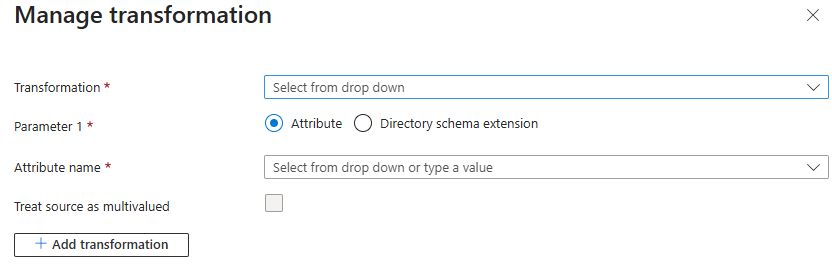

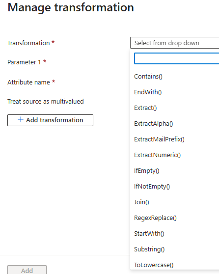

So when we go to add the claim, and add the value, were getting a ‘manage transformation’ screen and we dont know what settings to use for this screen. Then there is attribute list and the ad groups arnt in there… basically this is the step we stuck on. any help describing what you do here would be great. (i’ll upload the screen shots]

Here are the configurations you need to follow in Azure:
In Manage claim, set Name to n8n_instance_role, leave Namespace blank, and don’t select anything for Choose name format.
Under Claim conditions, set User type to Members, then in Scoped Groups select your AD group. For Source, choose Value (not transformation), and set Value to global:admin.
For members, you’ll need to create another claim or condition and just swap out the AD group in the Scoped Groups field, keeping everything else the same but changing the value to global:member.

If it appears exactly like that, n8n will apply the role on login. Also, ignore the Manage transformation section completely—you don’t need it.

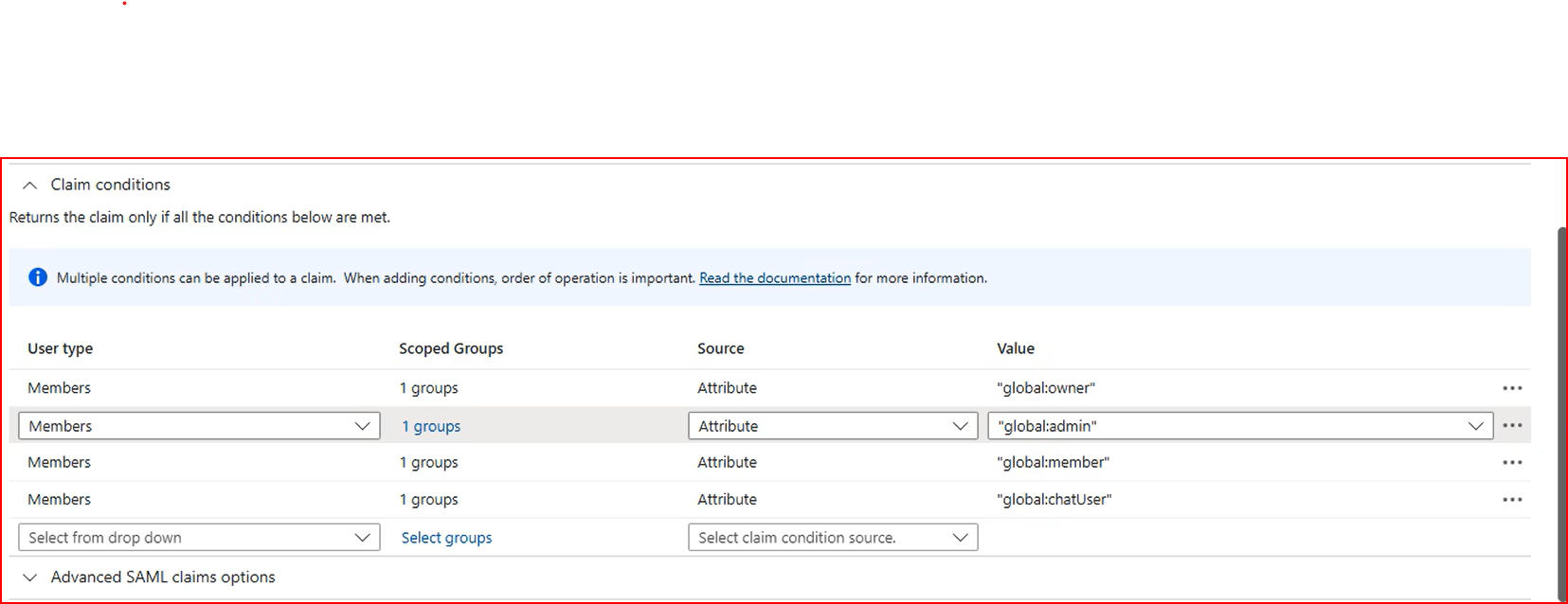

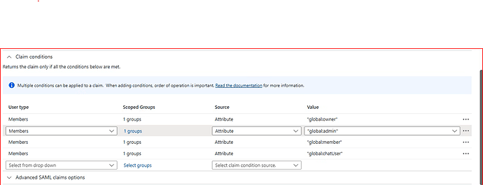

I think were almost there. I see the attriubute appear in the saml now.. however the order seems wrong. I happen to be in 2 groups and even though we did top down, it seems to match to admin each time rather than owner. What we doing wrong? see screenshot of the claim
