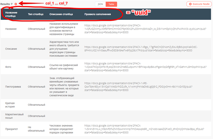

How to swap columns with rows?
Is there such a possibility in the function node?
Hi Roket! Can you please elaborate? We are not exactly sure what you are looking for.

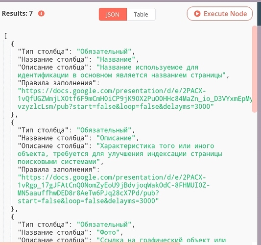

I have a json from a webhook that always has 4 columns and a different number of rows. I would like to convert this structure to 4 rows and a different number of columns. And always equate the column keys to the “uuid” values of the converted strings.

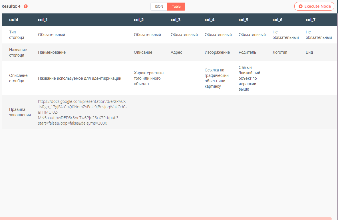

Thank you for your attention to my problem, but this solution did not work for me. I am not a programmer and have no JS conversion skills.
Applying your code I got the following (.

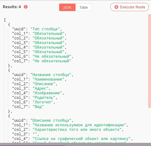

And I need such a data structure.
Perhaps, it is not quite clear to you because of the screenshots in Russian? I can make an example problem in English, if it helps to understand better.
