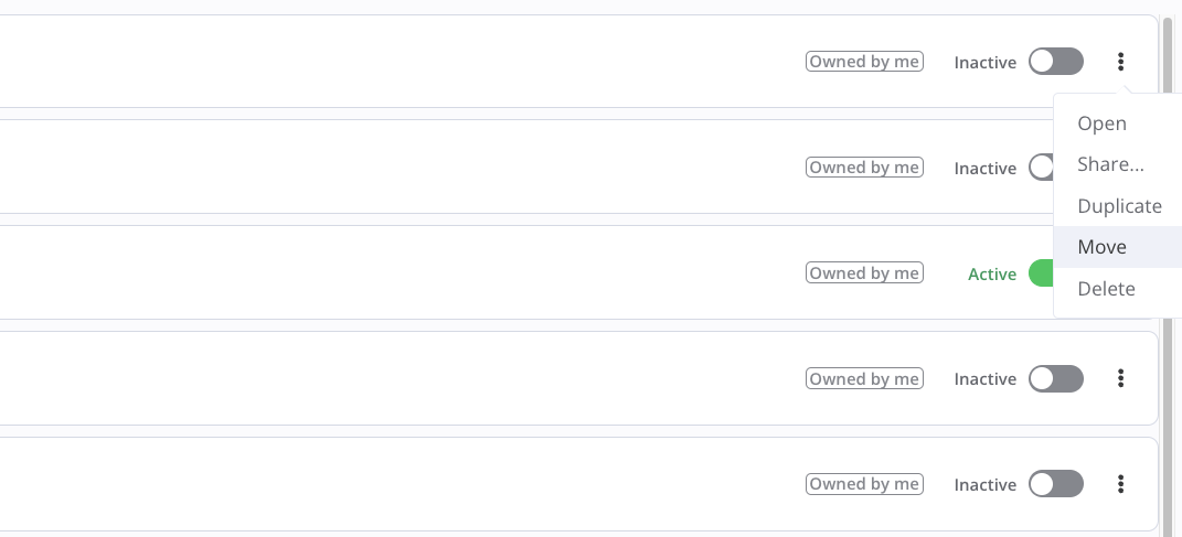

Hi! I tried this today (clicking 3 dots menu), but Move option isn’t on there. Any possible reason why?
n8n Version: 1.45.1
Running n8n via n8n cloud
Mac OS

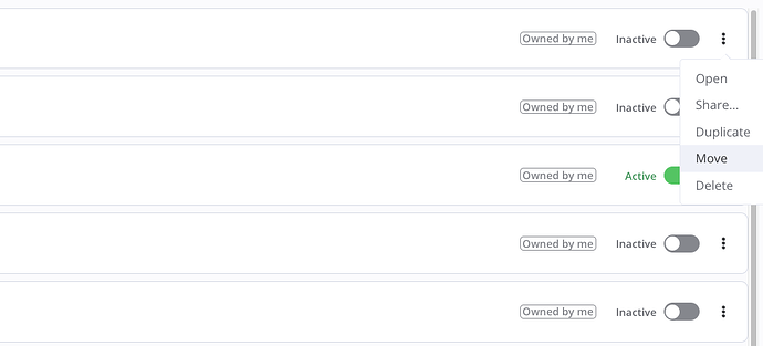

Hi @acee-thesquad it has been released in version 1.46.0 - you should now see it in the workflow list as below.
