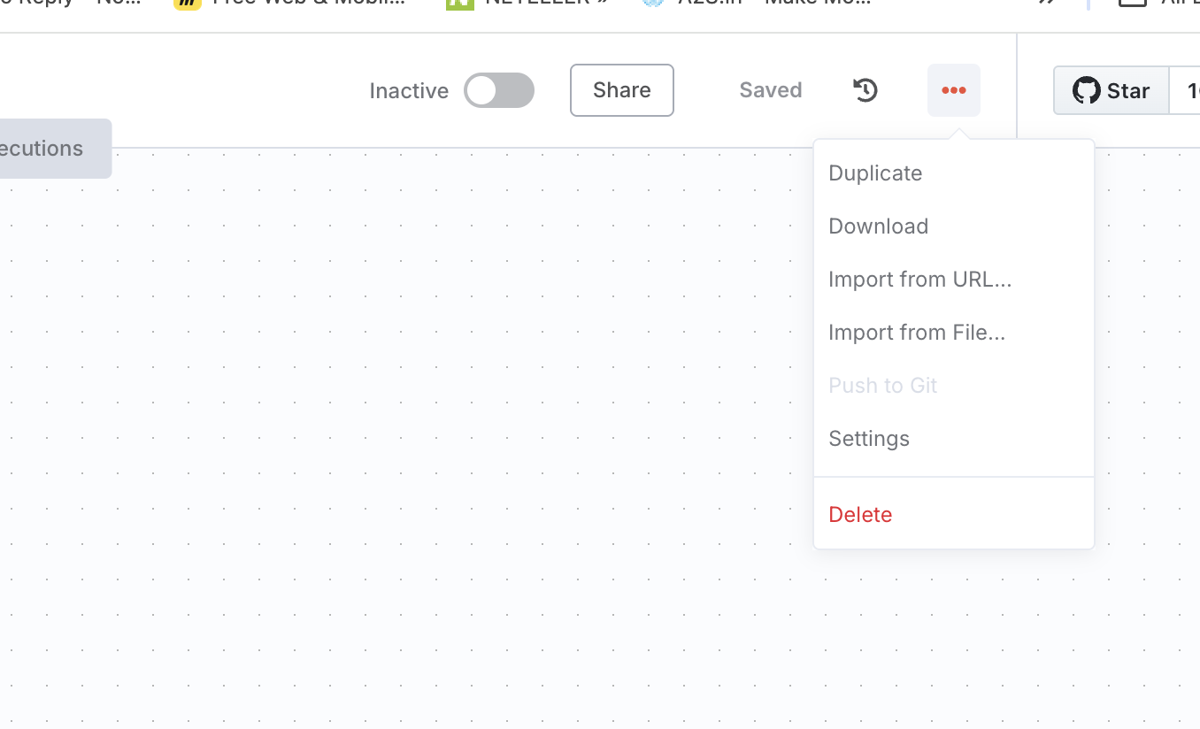

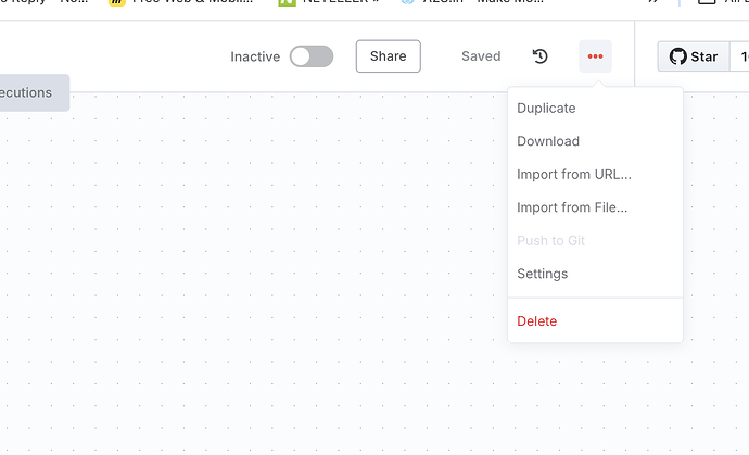

Hey @Gouravdev

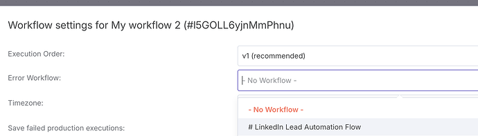

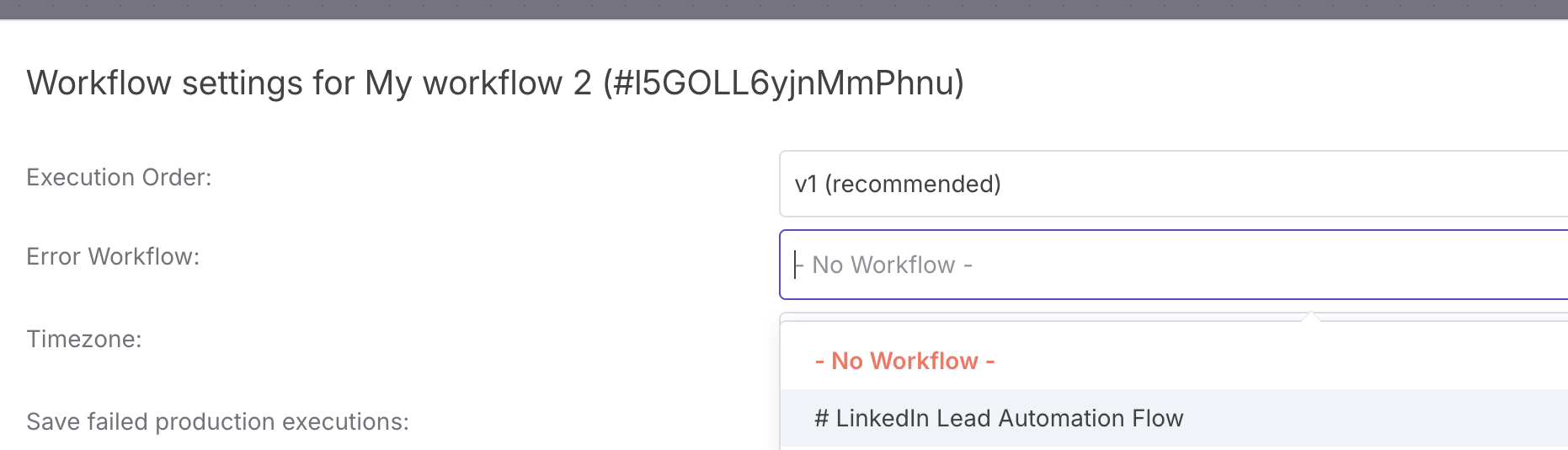

In the setting, you need to select the workflow,
Then it should send errors to this trigger node.
Samuel
Yes, this setting is already being enabled.
@Gouravdev
Okay, and on the 2nd workflow under execution history do you see anything there? I think you mentioned not, and are using running this in production mode ie schduled trigger, not within the gui workflow.
See above, the node http request settings has error route enabled and attached a stop and error. and this works (tested)
