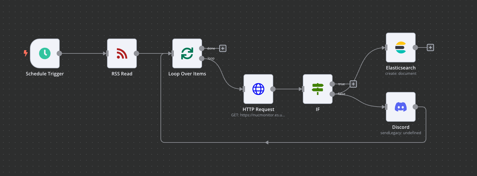

I ran into the same issue. My problem was that the date of the article wan’t exactly the moment of publishing. The RSS Feed trigger just compares timestamps, it doesn’t have a database of what it has already seen. If the polling rate is too quick compared to how old the publish timestamp is back dated (often to the beginning of the day, or something with timezone issues), the feed trigger doesn’t fire.
My quick fix was to use a local database to record all the links I had seen before. You can use anything including google spreadsheet as that database, I just happened to use Elasticsearch because that’s easy for me as I use it every day.
Welcome to the community @Azathought. Yeah, I think your approach is much more suitable than the default polling approach just using timestamps when encountering such problems. This goes for most polling nodes of course, not just the RSS trigger.
It’s actually similar to what I’ve shared in the thread, just using ES as a replacement for the tool mentioned over there. It makes a lot of sense to use a tool you already have in place and are familiar with. For most RSS feeds even a Google Sheet could do :slight_smile:
