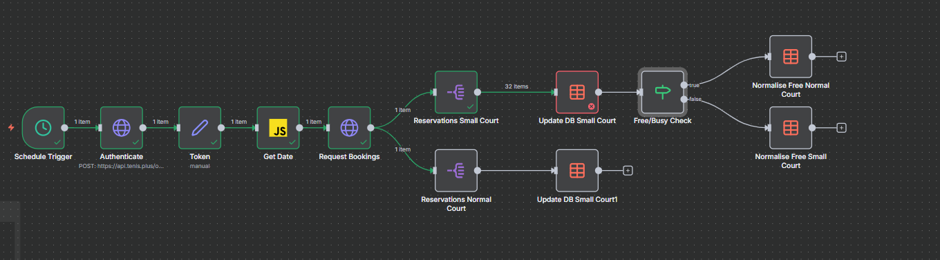

So I will be grateful to hear from you how can I accomplish my goal. I am attaching a screenshot from my current workflow but note that at some point yesterday evening I was already frustrated and made some weird implementations :smiley:
The spilt node is to separate the slots from 6 to 22.

Hi @OgnyanGuglev and welcome to the forums. Is it possible to share your main workflow in a code block so we can see what your prompt looks like. By the sounds of it, it might be a lot simpler to just fix the tool calling to the http request instead of trying to sync data into yet another table.
Here is the code block. I also think it might be solved without db but I could find a way to attach HTTP request node to AI agent.

I meant, please can you share the workflow where your AI agent is?
Oh right ok, so your prompt is nowhere near complex and long enough to instruct the ai agent on how to work and which tools to call. Can you give me a few rules and behaviours you want your ai agent to do, then I can help you improve the prompt. You need a 1 to 2 page prompt to make this work well.
No, its not complex at all.
For now there are these two separation - if the user asks questions about the club (rules, registrations, and anything about how to play the agent should use Pinecone DB with information from the FAQ. For questions about courts availability (free/busy) registrations it should call the API and get the latest information about the courts bookings. I am not sure how to structure my prompts but I couldnt find HTTPrequest node that works with the AI agent. Therefor I cannot make the agent to authenticate and use the API. That is why I decided to split into two workflow and put the availability information in table which will be consumed by the AI agent
If you need to make more complex rest calls which might have some special auth requirement, simply create a sub workflow which does all this and then use the sub workflow in the agent. However you’ll need to create a prompt which instructs to agents in more detail. Rememer that these agents dont know what you want and how you want them to behave, so you need to give it instructions just like you would give a human who would be doing the same task. I can create a sample workflow if you need which you can then use as a template and just replace the parts you need from your side.
I would love to see how you would do it.
