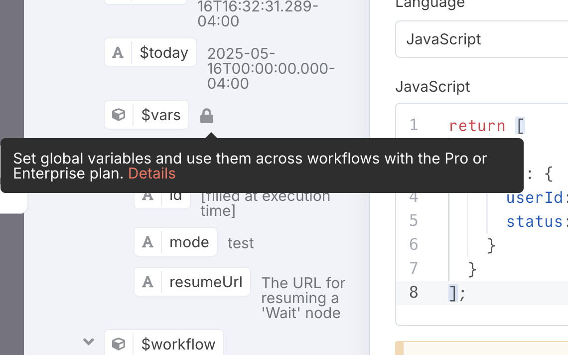

If you’re on enterprise or cloud-pro, you can use $vars (but, fyi, those are read-only).
If you’re not on one of those licensed versions, $getWorkflowStaticData(type) might suit your needs.

Hello! Thank you for the responses, but I had to change the workflow because none of the proposed solutions worked. I ended up saving the information to the database and retrieving it later. I believe the suggested solutions only work on the paid version of n8n. But thanks anyway!
