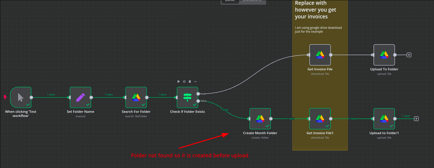

Hi @grabekm90,
Basically you need to:
  1. Set the Folder Name for the current month
  2. Check if the folder already exists in google drive
  3. Create it if it doesn’t exist
  4. Upload the file to the found/newly created folder

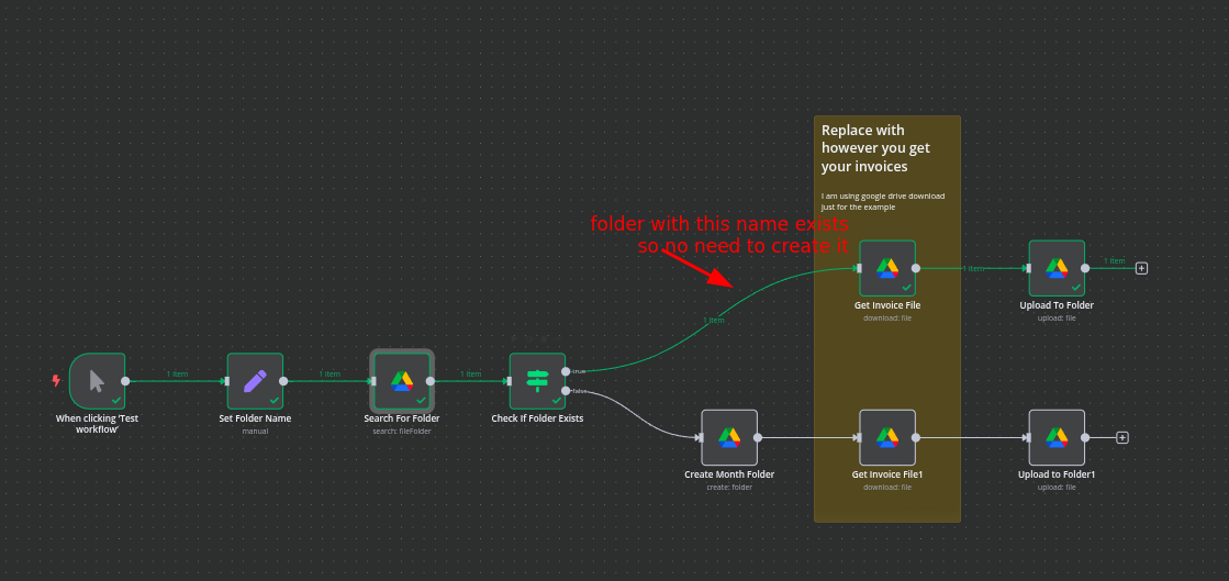

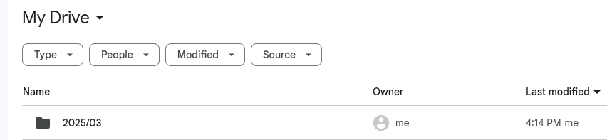

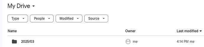

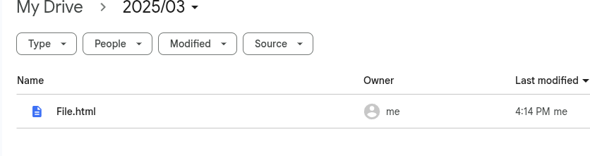

I cobbled up a workflow and tested it just now and it worked:
See screenshots of my test
EDIT: Forgot to mention that it’s very important to turn on "Always output Data’ setting on the Search For Folder node or the workflow will not work when the folder is not found.
Always Output Data
Also if you have multiple folders with this name the file will be uploaded to a random one of them. (Folder names are not unique in Google Drive) But this should be fine as long as you don’t manually duplicate the folder.
