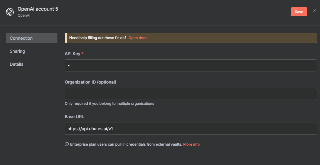

If Chutes is an OpenAI-compatible API, then all you need to do is add OpenAI connection and update the “Base URL” to https://api.chutes.ai/v1
Please give it a try and let me know whether it works.

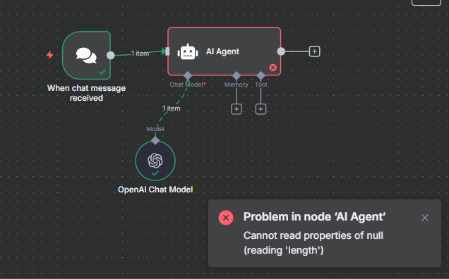

I am getting a length error repeatedly, regardless of the input prompt.
Hmm, maybe it has some limitations,

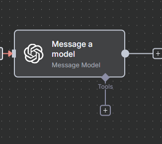

Could you try using it like the “Message a model” node?
