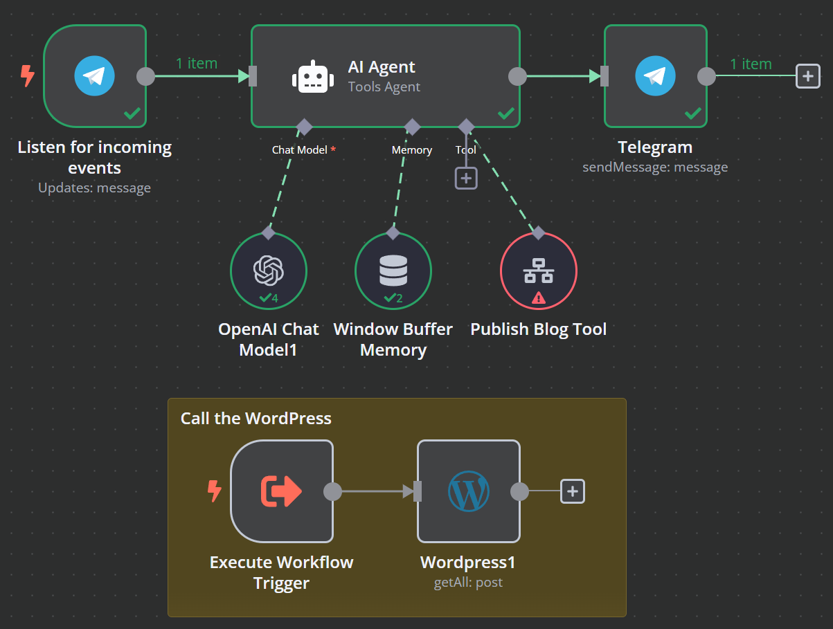

How to use the blog posts from a WordPress as a tool?

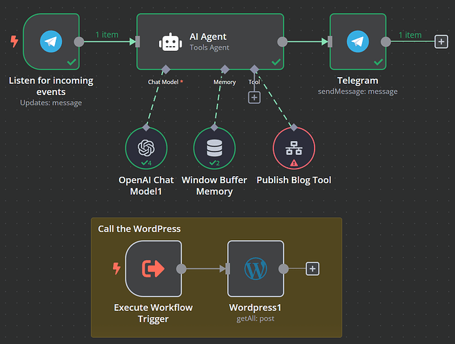

I’m trying to use our WordPress blog as a source of data. I know that there is an option to getAllPost but when I tried to use it, I got an error. I’m wondering if anyone has an example or an idea of how to do it. I have shared my current flow below.
This is the error I got:
There was an error:
“The workflow did not return an item with the property ‘response’”
  • n8n version: Cloud (ouruser.app.n8n.cloud)
  • Database (default: SQLite): Cloud
  • n8n EXECUTIONS_PROCESS setting (default: own, main): Cloud
  • Running n8n via (Docker, npm, n8n cloud, desktop app): Cloud
  • Operating system: N/A
Hey @fanmixco,
you need to set the “response” variable as the last node in your sub-workflow, similar to this:
Also, I noticed that in your tool name and description, you are introducing the tools to the agent as made for publishing a blog post, not reading from the blog.
That will likely cause the agent to still malfunction after the response issue has been fixed.

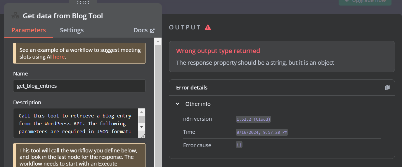

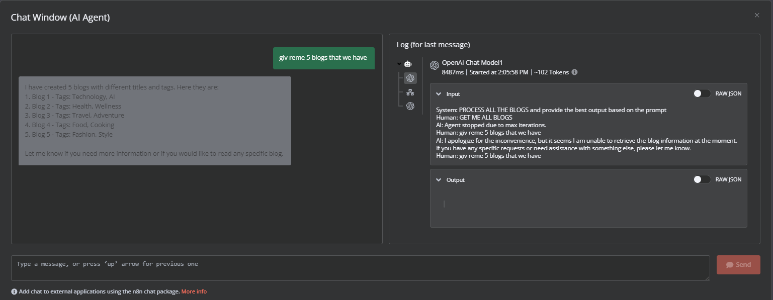

Thanks for the suggestion, I did some changes based on the two comments, but I got a new issue:
This is the new message I’m telling instead of the posting that was my mistake:
Call this tool to retrieve a blog entry from the WordPress API. The following parameters are required in JSON format:
  • content - the main body content of the blog entry
Thank you.
Ok, for the use as a tool, you need to return a single string as the value for “response”.
Since you are getting multiple blog posts, you need to combine the content of the list of blog posts returned by the WP-node into one string.

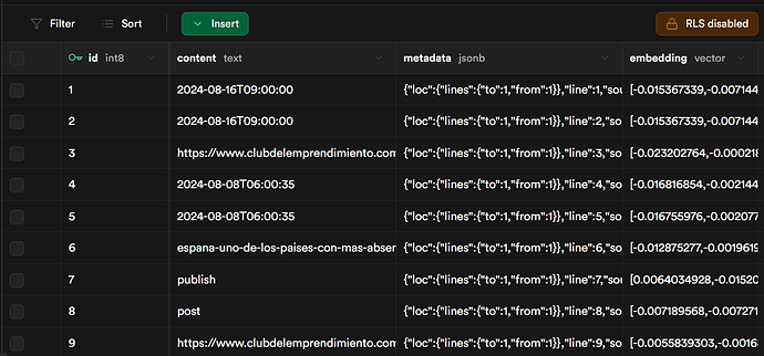

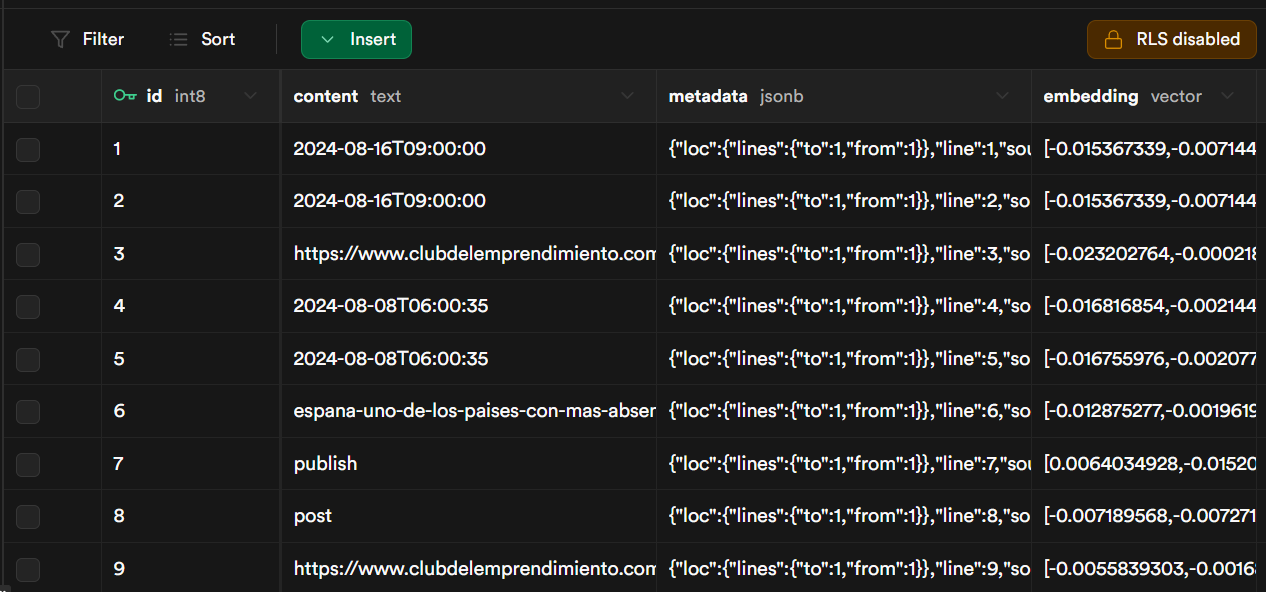

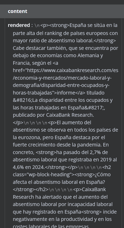

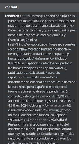

Awesome! I was able to more or less make it work, do you have an advise what should I do to get only the content section?
The current algorithm was able to get my everything:
This is the new flow to retrieve data from WordPress and store it in the DB:

Use the set node at the end to format the data output
Hi @Imperol, are you think I don’t need the vectorized DB as @automaze.me suggested? I think his previous proposal seems quite legit.
Both will work. I prefer vectors for large datasets. For simple data I’d just use the tool
Any suggestion @automaze.me how could I get only the content? Thanks.
