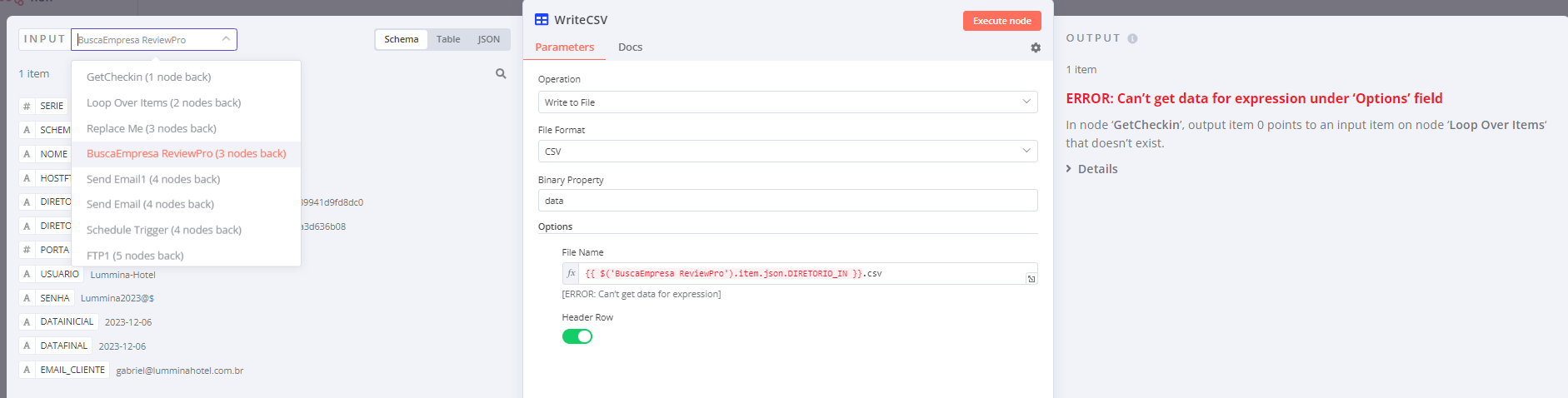

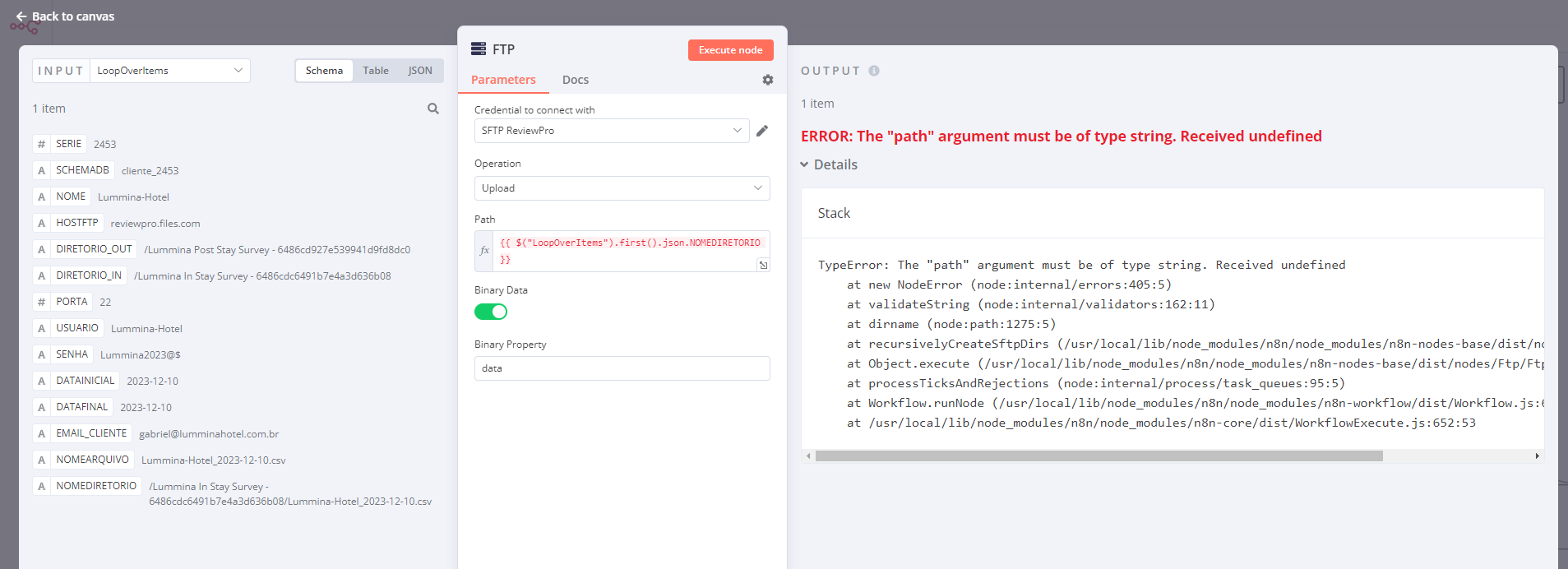

I started using N8N and I’m having a problem that I want an idea of how to solve.
I have a select that returns data from some companies that I need to post in an SFTP.
It turns out that I have the location of the director in the BuscaEmpresaReviewPro node, how can I use this field value in the FTP?
Basically it is using a value from a Node that is not directly before it.
If you open the node where you want to use the value of the previous node on, you are able to select the node of which you want to use the value via the selector on the top left side (only if the node got executed before).
You will then see all th available values, and you are able to drag and drop any of the values on the parameter you want to use it on.
Thanks for your response, I’m very excited to be using n8n.
I had already made this option, but this error occurs:
ERROR: Can’t get data for expression under ‘Options’ field
In node ‘GetCheckin’, output item 0 points to an input item on node ‘Loop Over Items‘ that doesn’t exist.
I tried to get the value from the loop, but the error also occurs
Item Index: 0 | In or underneath Parameter: Options
Cause
Data below may contain sensitive information. Proceed with caution when sharing.
“fileName”: “={{ $(‘Loop Over Items’).item.json.DIRETORIO_IN }}”,

Ah actually ignore that. I saw that wrong in a screenshot above. If it would have only one item the whole Loop Node would not make any sense.
In this case, if you have set the Batch-Size to 1 you could probably do:
Ah yes, that is expected. Realized that myself after I thought about it a minute. For that reason did I post another suggestion just a few minutes after that.
