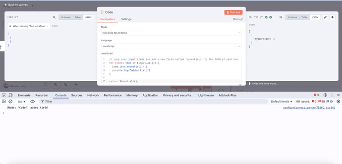

You can try adding console.log("log line") if you want to just see it in the frontend
  "nodes": [
      "parameters": {},
      "type": "n8n-nodes-base.manualTrigger",
      "typeVersion": 1,
      "position": [
        0,
        0
      "id": "f5493a26-b590-4929-979c-6a9d4971fc17",
      "name": "When clicking ‘Test workflow’"
      "parameters": {
        "jsCode": "// Loop over input items and add a new field called 'myNewField' to the JSON of each one\nfor (const item of $input.all()) {\n  item.json.myNewField = 1;\n  console.log(\"added field\")\n}\n\nreturn $input.all();"
      "type": "n8n-nodes-base.code",
      "typeVersion": 2,
      "position": [
        220,
        0
      "id": "fbba4698-d187-4563-9af4-78a831c927ef",
      "name": "Code with logging"
  "connections": {
    "When clicking ‘Test workflow’": {
      "main": [
            "node": "Code with logging",
            "type": "main",
            "index": 0
  "pinData": {},
  "meta": {
    "instanceId": "ace885814db9b67dd2490b365735363256b8712c3324138bc33d0a3d82ef8908"
Yes, I tried that but it is not recorded at the server level.
