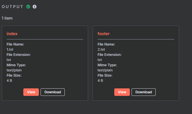

Hmm, I tried using the workflow, but unfortunately ilit outputs the index and footer as seperate documents. Do you guys have a fix for this? I’m having a hard time adding a footer.
check the Merge node operation type. it should be combine by postition.
Unfortunately that does not seem to work for me. This is an example flow:
What is not working? I see two files
Correct, and that is exactly the problem. The Gotenberg should take two binary as input files, and combine them in a PDF. Now it looks like it’s processing them one by one rather then taking in the two data flows.
So inputting 2 or more binary data types, always results in multiple outputs, where this should not be the case.
