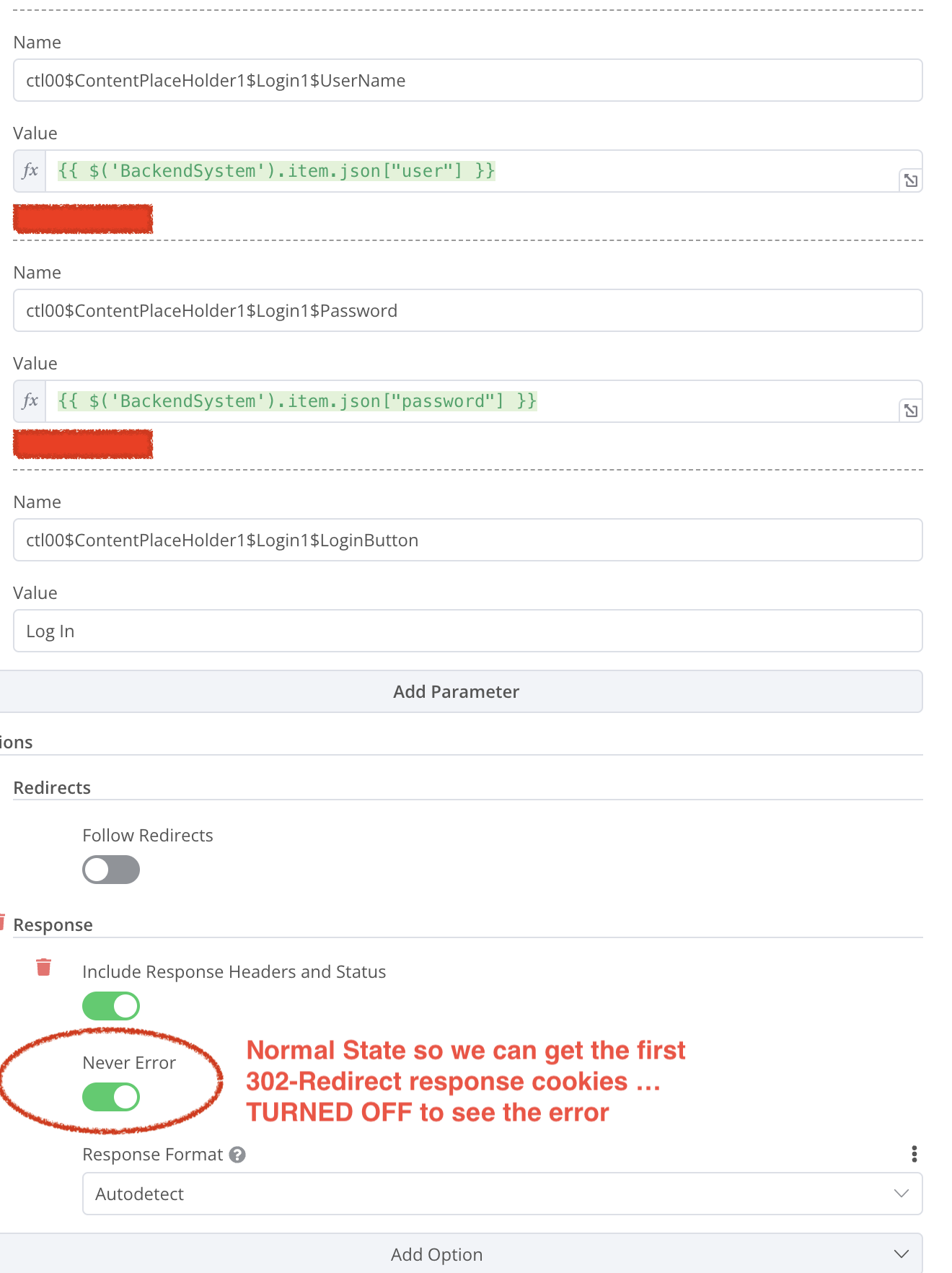

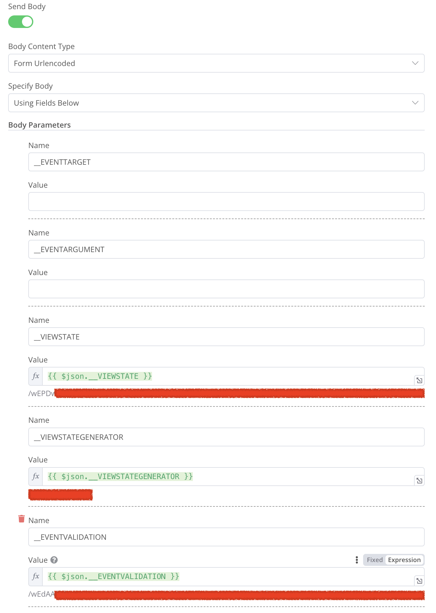

Here @EmeraldHerald is the HTTP Request node configuration.
As you can see, we are sending a POST to login and interrupt the follow_redirect so we can get the auth-cookie we need downstream.

The 302 is exactly what you have noticed a redirect code, If you have redirects disabled I would expect to see the error as the request won’t complete.
If you want to interrupt the redirect then what you have in the settings looks to be correct as we would treat a failed redirect as an error.
Hi John … yes we don’t want to follow the 302/Redirect because we need the response header that comes with that redirect; that’s why we turn on “Never Error”—this same node in a production env over http/1 work without a problem.
