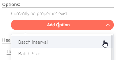

you can also use the batch interval and batch size if that helps with throttling

How to use batch size and batch interval?

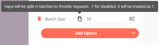

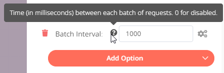

so you say how many requests you want to send in each batch and the interval between batches.
I use this to throttle requests against APIs that have rate limiting,

If you want that only one executes at a time you can set “Batch Size” to “1”.
@Jan, I have set the batch size to 1, batch interval to 9000. There are 900 requests, it should take atleast 2 hours, but its finishing in 10 minutes. Is it because multiple batches are running simultaneously. I only want 1 thread, 1 request. As there are calculations involved, which could change based on prior request. Currently all are executing simultaneously.
