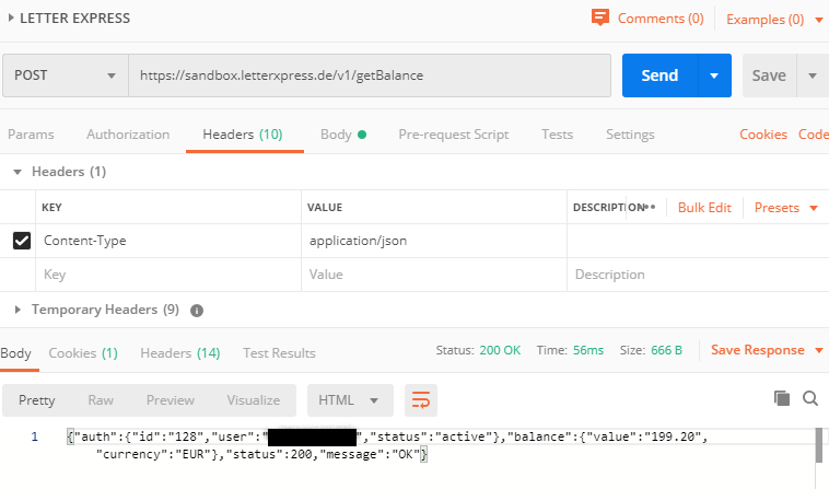

last thing: I would use this api:
What do you think: Auth in Header ?
  "auth": {
    "username": "(string)",
    "apikey": "(string)"
This in Body ?
  "letter": {
    "base64_file":      "(string)", // Optional bei einem Update-Request
    "base64_checksum":  "(string)", // Optional bei einem Update-Request
    "address":          "(string)", // Optional
    "dispatchdate":     "(string)", // Optional
    "specification": {
      "color":"(int)",
      "mode":"(string)",
      "ship":"(string)",
      "c4":"(string)" // Optional für C4 Versandtasche unter 9 Blatt
Here it not works in Header and Body or together in Body.
What do you think ?
Stefan
Hi, in PHP it works like this:
[auth] => Array
[apikey] => apikey
[username] => username
In Postman it works:
Any Idea ?
Thanks,
Stefan
I have it !!! Thanks, Stefan
