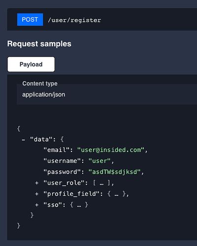

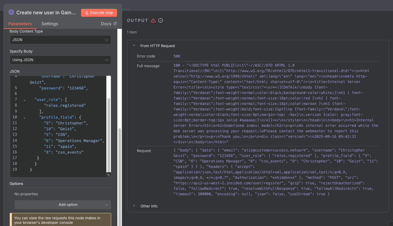

I use an http call to register a new member in Gainsight CC. Unfortunately I always receive a code 500 internal server error. I have tried sending the payload either as Query Parameters or in the Body, using exactly the same JSON code.
When I do exactly the same with Postman it goes through without any problem. So what am I missing? Is there any additional setting required in the node?

I see from the screenshot, that your body property has a structure like that:
  "data": {
    "email": "",
    "username": "",
    "password": ""
but usually the endpoint service accept data in the below format
  "email": "",
  "username": "",
  "password": ""
Well, Gainsight API documentation specifically mentions that structure I used.
I did test it now without the “data”: part and the result was the same error code 500, so I think we can safely discard that option.
Actually, when sending it via Postman it uses the “data”: part.
Hello @ChristopherG
The error message I’m seeing is “Undefined index: model“. Perhaps this “model” information is required in your JSON body as well?
Can you use the Import cURL button in the HTTP node (top-right), and use the working cURL that you can export from Postman?
Also, can you try enabling Headers in the HTTP node and add:
Gainsight API docs don’t say anything about that :thinking:
Nope, tried your suggestions to no avail, sorry.

This is the payload:
“data”: {
“email”: “[email protected]”,
“username”: “Christopher Geist”,
“password”: “123456”,
“user_role”: [
“roles.registered”
“profile_field”: {
“9”: “Christopher”,
“10”: “Geist”,
“5”: “CSN”,
“6”: “Operations Manager”,
“11”: “spain”,
“8”: “csn_events”
Thank you, just a heads up: always post code into a code box, because otherwise it breaks due to the quotes being different symbols. Also that how you can insert a workflow UI in your comment :slight_smile:

Now, I checked your workflow - I assume you have the OAuth2 credentials setup for that HTTP node. How do you authenticate in Postman? Do you notice and Headers that are there but missing in n8n?
Gainsight OAuth2 credentials are set up and working, I use them in a previous step as well.
The token in Gainsight expires after 2h, so in Postman I have to get a new token first and then I run my command. These are the headers in Postman, they are all automatically set.
As you suggested, I enabled headers as well in the node, but it didn’t make a difference.
Could you try to replicate the Authorization header and it’s value in the node? It might require turning off the OAuth2 used earlier, so they don’t mess with that.
Hi,
sorry for not responding early, I’v been busy with other stuff.
Actually I have a ticket open with Gainsight Support about this error, so I’m waiting for them to respond.
No worries, still you can try setting the HTTP node like in my example below? Might be helpful in the overall investigation:
Just got a reply from Gainsight Support.
The API requires the values (names) in the dropdown menus to be numbers. Example: in the dropdown country, the value “Spain” has the internal value “207”. Unfortunately this is nowhere documented in the Gainsight API docs.
Having said that, what’s the best way to do this conversion in the workflow?
A Code node with JSON or the new data table node?
Thanks
You could just use an Edit FIelds node and define it as so:
But I’m not sure if this will address the issue, if the request works through Postman, with the same values.
