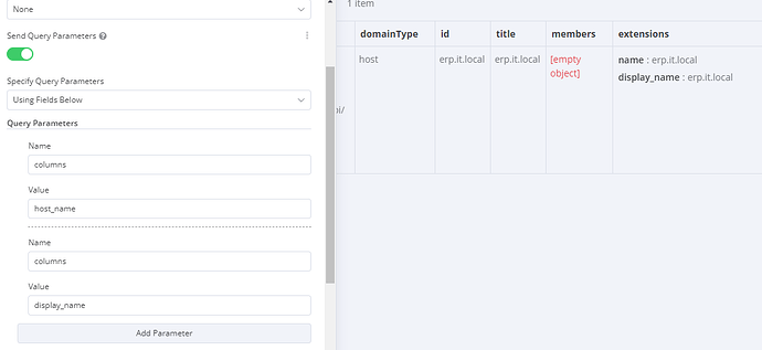

@aya , 1st my fault was, that this is no body parameter, but a query parameter :man_facepalming: , cause its a get, i created before a post request.
But if a add one “columns” parameter now to request i worked, but if i add a second field, also with name “columns”, it will take only the last one.

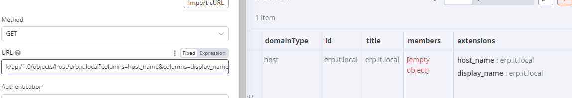

if i add the fields direct to the url request, like:
“https://example.com/cnit/check_mk/api/1.0/objects/host/erp.it.local?columns=host_name&columns=display_name” it works.
Screenshot Fields:
Screenshot URL:
Ok, i found the solution:
and add
Nice you found the solution! :clap:
