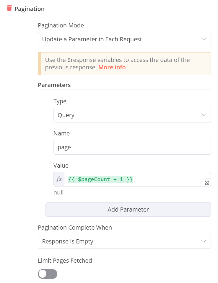

Hey @tienhuy,
Without more details on the API you are using the below is the best I can come up with, You will just need to work out what to use for the “Pagination Complete When” option.
I also had some issues getting to understand it in the first place, but checking my API response header and footer data it was clear and mostly I get through with the following:
Sometimes you need to activate “Include Response Headers and Status” on your node to get the next page URL if using “Response contains next url” instead of the above example.
Thank you very much, it works perfectly.
