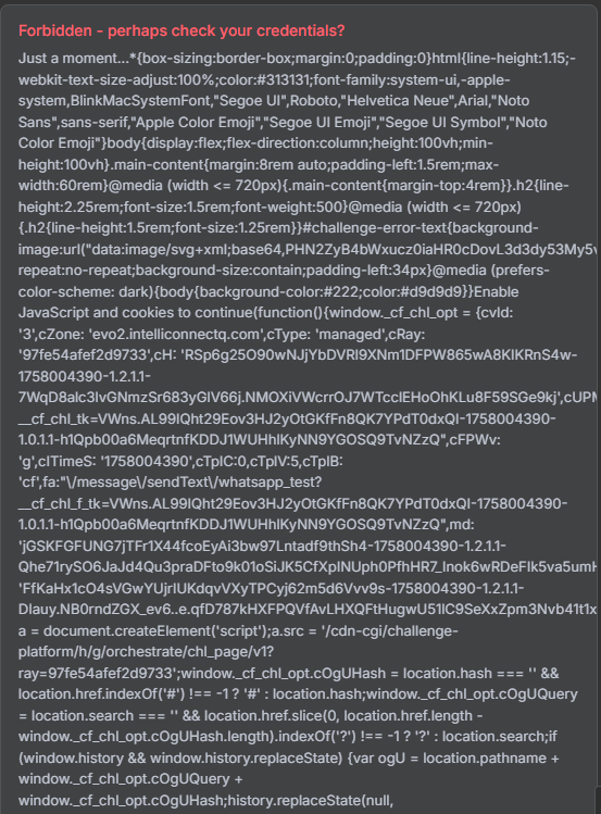

I’m trying to send an HTTP request in n8n to the following endpoint:
https://evo2.abc.com/message/sendText/whatsapp_test
But instead of the expected API response, I get a 403 Forbidden with Cloudflare’s “Just a moment…” challenge page (the HTML with __cf_chl_* tokens).
It looks like Cloudflare is blocking my request because it doesn’t pass the JS/cookie challenge. The message also shows “Forbidden – perhaps check your credentials?” but I believe it’s not credentials-related, rather Cloudflare protection.
