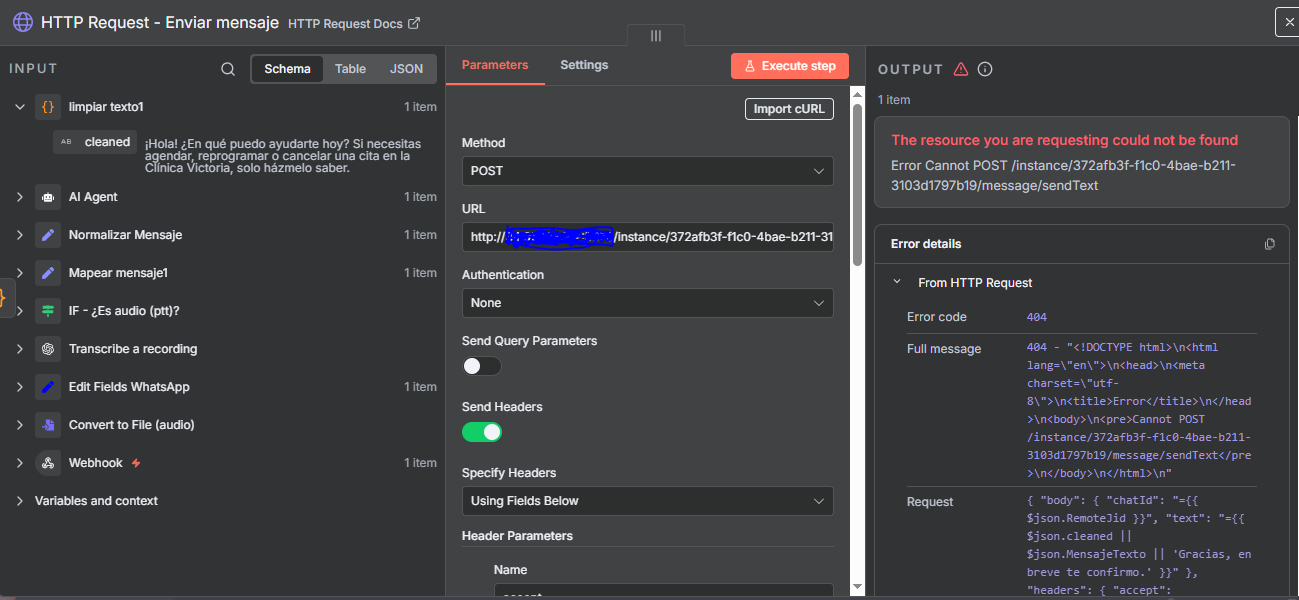

I am trying to send a request through an HTTP Request node in n8n to interact with Evolution API. However, the node fails with a 404 error saying the requested resource could not be found.
The API should return a JSON response, but instead, I get an HTML error page with:
Cannot POST /instance/372afb3f-f1c0-4bae-b211-3103d1797b19/message/sendText
What is the error message?
The resource you are requesting could not be found
httpCode: 404
  "errorMessage": "The resource you are requesting could not be found",
  "errorDetails": {
    "httpCode": "404",
    "rawErrorMessage": [
      "404 - \"Cannot POST /instance/372afb3f-f1c0-4bae-b211-3103d1797b19/message/sendText\""
  • n8n version: 1.108.2 (Self-hosted)
  • Database: Default SQLite
  • EXECUTIONS_PROCESS: own (default)
  • Running via: Docker on Google Cloud VM (EasyPanel)
  • Operating system: Ubuntu 22.04 LTS
Hi there, looking at the error, i think the problem lies on how you setup the evolution API and making it publicly accessible
Like, the address might be wrong
So the error is saying tht it cant find any process on that endpoint, so what you can do is maybe try to test it with like a postman as well and see if tht works or not
and to make it publicly available, try using something like cloudflare tunnel, ngrok, or any of tht similar tunneling services
