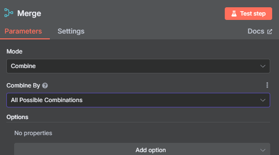

I’ve add a merge node before the http request to bring the binary file but still doesn’t work
As you can see in the image binary data is available, but still getting the error
hope someone can help, thanks!!
Hi @alexis.morgado
Use the Merge node in Combine mode,
and set the Input Data Field Name in HTTP node to data
it worked!!
thanks mohamed3nan!!
You’re welcome.
Kindly mark the reply as the solution so others with the same issue can find it easily :white_check_mark::pray:t2:
