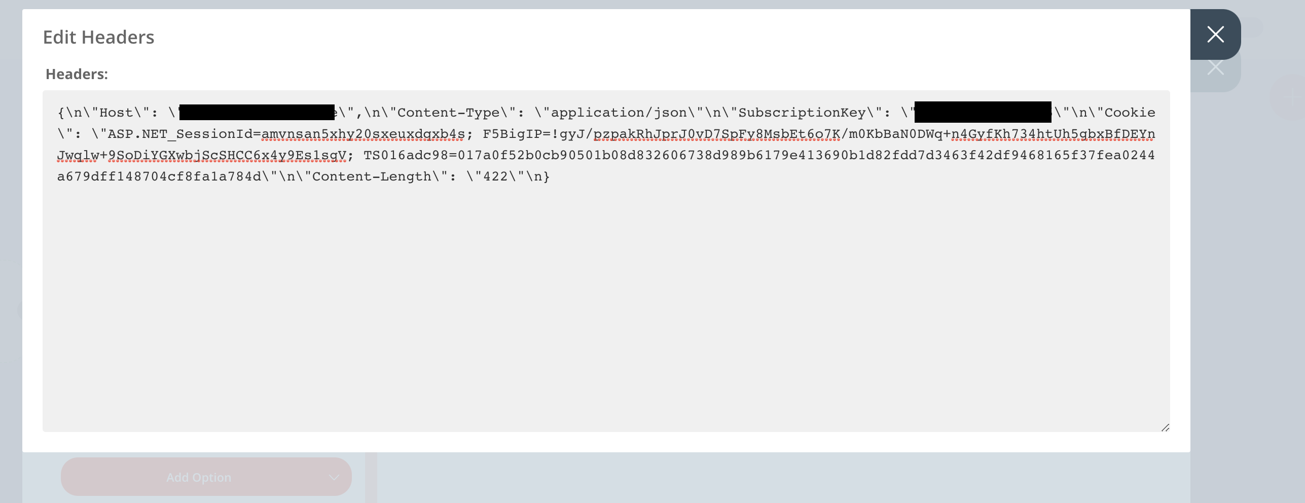

I need to send data via https request to an API and did not get it on track. Perhaps you have a recommendation.
I have this PUT header (with some anonymisations :-)):
PUT /kd_1/api/V1/Profilcandidate HTTP/1.1
Host: myyyyyy.yyyyyyy.de
Content-Type: application/json
SubscriptionKey: yyyyyyyyyyyyy
Cookie: ASP.NET_SessionId=amvnsan5xhy20sxeuxdqxb4s; F5BigIP=!gyJ/pzpakRhJprJ0vD7SpFy8MsbEt6o7K/m0KbBaN0DWq+n4GyfKh734htUh5gbxBfDEYnJwqlw+9SoDiYGXwbjScSHCC6x4y9Es1sgV; TS016adc98=017a0f52b0cb90501b08d832606738d989b6179e413690b1d82fdd7d3463f42df9468165f37fea0244a679dff148704cf8fa1a784d
Content-Length: 422
and this body:
“Country”: “DE”,
“BewerberId”: “500845221”,
“Kampagne”: “Test nexum 22/04/21”,
“Source”: “”,
“Answers”: [
“Key”: “VerfuegbarAb Value”,
“Value”: “1”
“Key”: “Entfernung”,
“Value”: “300”
“Key”: “GehaltswunschProMonat”,
“Value”: “3000”
“Dokuments”: []
And it put it into the fields with this settings! Without Auth because I have just the subscriptionkey in the header.
Bildschirmfoto 2021-04-23 um 10.10.35|645x500
I put the header and body in the parameters field like mentioned above. But it is not working.
Thx and kind regards
Sebastian

I made it like this now but it does not work:
What is the error that you get?
it is loading and loading and i get no result
Hey @mezkalito,
Do you mind sharing me the URL and other data to make the call. Feel free to send it to me over a DM. The above solution should have worked. I will try to replicate the issue and try to get back with a working solution.
Hey @mezkalito,
I removed the Cookie and the Content Length fields from the headers and I got a success response. I am not certain why this works, but it might depend on the way the API is designed.
