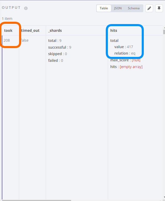

I am trying to get the records from the elastic search using HTTP Request. When I try to get the bulk records for last 14 days.
When I check in Kibana I am able to see around 417 records from the discover, When I execute same query in n8n , I am able to get only 208 records only.
I am able see as below because of time-out or may I know the reason :
may I know how can we get full records using this node or please suggest me on this.

Hi @DilipChiru, I am afraid I won’t be able to answer this questions purely based on the information you have provided. My first guess is that you might be using different indices. Kibana might default to querying multiple indices whereas your n8n node might not do this.
Can you confirm the exact structure of an example Elasticsearch document you can’t find using n8n and share the exact workflow you are using to query this document?
Edit: From looking at your screenshot it seems you’re actually seeing the correct number. The value 208 in the took field simply specifies the milliseconds it took Elasticsearch to execute the request as per Search API | Elasticsearch Guide [8.10] | Elastic.
You want to look at the hits field instead:
