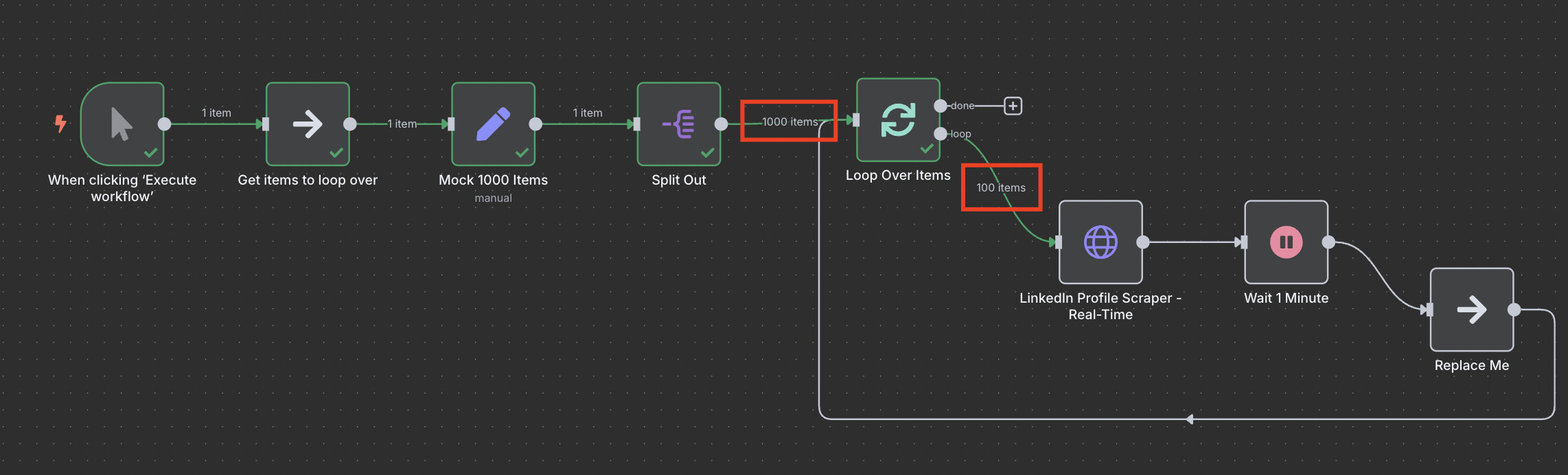

Try batching your requests like in the example below. I mock out 1000 items in a list, then I use the loop node and set the batch at 100 items, wait 1 minute before I continue with the next set of 100 items/http calls. This should limit your rate limits to 100 items every minute. Off course you’ll need to adjust the waiting time according to the rate limit rules of the api youre calling.
In this case the Loop node will run 10 times. 10x100 = 1000 items
