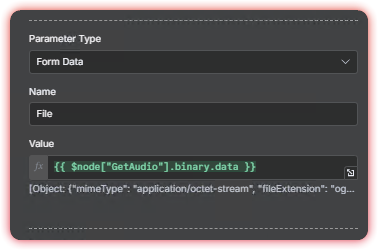

After configur the HTTP request module I get alway the same error attched.
source.on is not a fuction

              "parameterType": "formBinaryData",
              "name": "file",
              "inputDataFieldName": "={{ $node["GetAudio"].binary.data }}"

Hi @Claudi
I think you need to edit this part:
Change it to something like this:
And only enter the input field name, for example: data
Let me know if you still have any issues
If this solves your problem, kindly mark the reply as the solution :white_check_mark::folded_hands:t2:
Yes, It has worked fine. Thanks.
