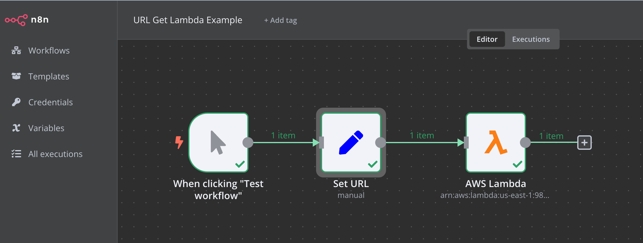

@First_Spark_Digital - haven’t forgotten about you! I was able to get the whole thing up and running! That said, it’s not for the faint of heart. At it’s core, it takes the URL and passes it to an AWS Lambda which runs a get request and returns the response back from the get request. This lambda invocation can be integrated into any workflow in n8n pretty easily.
Workflow:
Response from Lambda in n8n:
AWS Components:
I created a github repo (GitHub - Workflowsy-io/spark-digital-lambda-n8n-poc · GitHub) with all the necessary code that outlines all the steps I took (beyond creating an AWS account initially).
I’d be happy to help get you all setup with this if it’s of interest as AWS in itself can be a bit much. Just let me know if you have any questions or how I can help and we can go from there!
