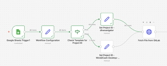

I am building a workflow to automate hyperlink updates in a GitLab repository.
Google Sheets TriggerFetch content from GitLabReplace stringCreate Merge Request
My HTTP Request node (Fetch File from GitLab) stays “Executing” infinitely. It never returns an error, but it never completes.

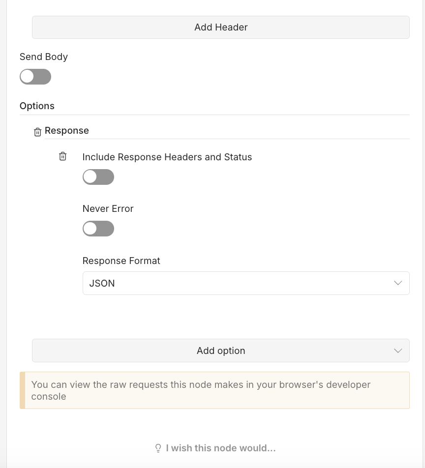

  • Response Format: JSON

Hi @shontzu !
Your request is going to the /raw endpoint, which returns plain text, not a JSON API response.
When you set the HTTP Request node to “Response Format: JSON”, n8n tries to auto-parse the body as JSON and the node never finishes correctly.
Set the node to “Response Format: String” instead.
Then, in the next Code node, manually parse it:
const data = JSON.parse($json.body);
return data.map(u => ({ json: { url: u } }));
This makes the request complete normally and still gives you usable JSON for the rest of the workflow.

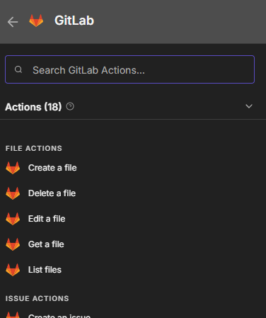

Hi @shontzu, welcome!
Is there any reason to use HTTPS requests rather than the built-in GitLab node?
