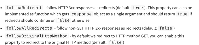

Getting set up, I’ve run into a problem with the HTTP Request node. I’m sending a POST request to an endpoint, but HTTP Request is not following the 302 redirect that comes back (despite followRedirect: true). As a consequence, the node is reporting a failure. I’m not quite sure where the issue lies, but if anyone has any suggestions they would be much appreciated.
