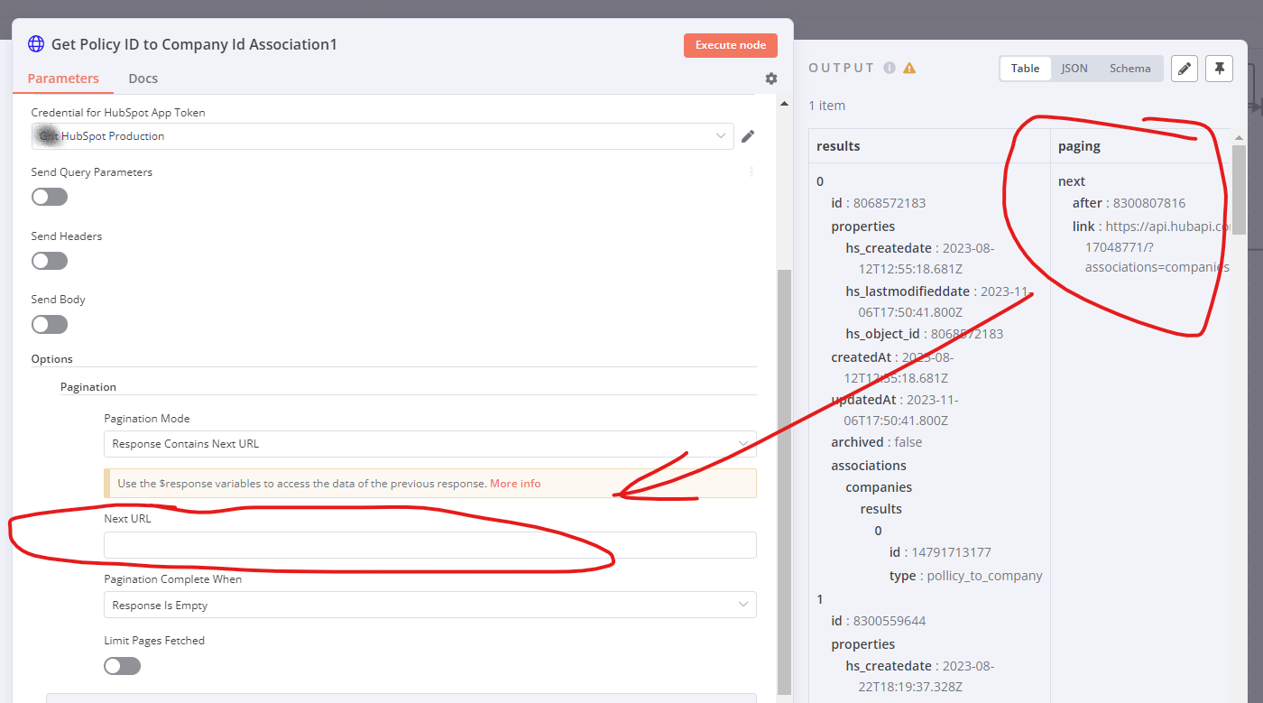

I am hoping this is an easy one for someone. I just cannot figure out the right format.
How do I write the response body in the http request pagination for the link in the response?
{{ $response.body[“next-page”] }}

Hey @davidl,
Looking at that I would say something like {{ $response.body.paging.next.link }} should do it.

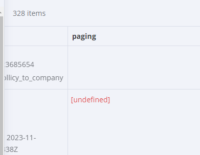

Here is what the last response looks like. paging is undefined.
