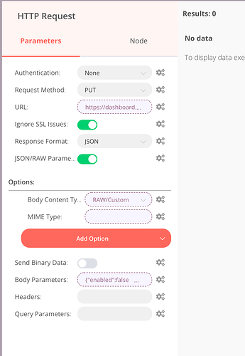

I’m having difficulty using HTTP request with a PUT passing a boolean as an argument via RAW/CUSTOM

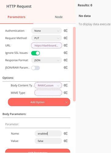

With params as per screenshot. I have tried “enabled”:false in inverted commas and also as an expression.

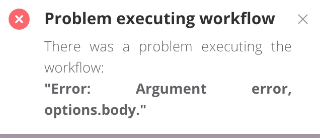

It generates the error![n8nOptionsBodyError|636x274]
I also have tried enabling JSON/RAW Parameters
It generates a temporary redirect error.

Error Message when JSON Raw Enabled.
Body Error that is generated using RAW/Custom

Is there any particular reason why you set “Body Content Type” and “Mime Type”? Looking at the API I do not see any reason why it should be needed. Especially setting an empty “Mime Type” has for sure the potential to mess stuff up. I would try to remove everything under “Options”.

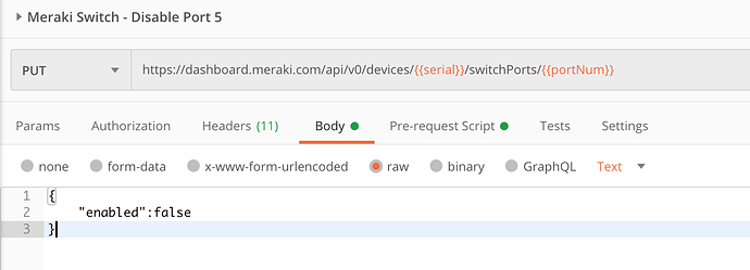

Using Postman, I can get it to work via this mechanism:
(I set the X-Cisco-Meraki-API-Key via the Header)

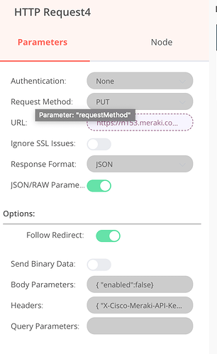

further to Jan’s help I was able to rectify the issue., I’ll post a more complete solution in the near future, For the record, the issue was more to do with HTTP Redirect’s and HTTP follow than with n8n execution.

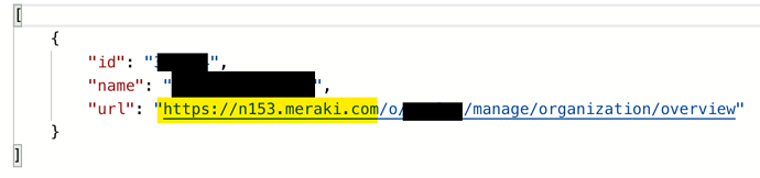

The correct order of flow in using the Meraki:
https://api.meraki.com/api/v0/organizations
The header contains your API key for Meraki
it
returns a JSON string with URL to utilise for API calls. Using that URL it works (ie. don’t call dashboark.meraki.com or api.meraki.com )

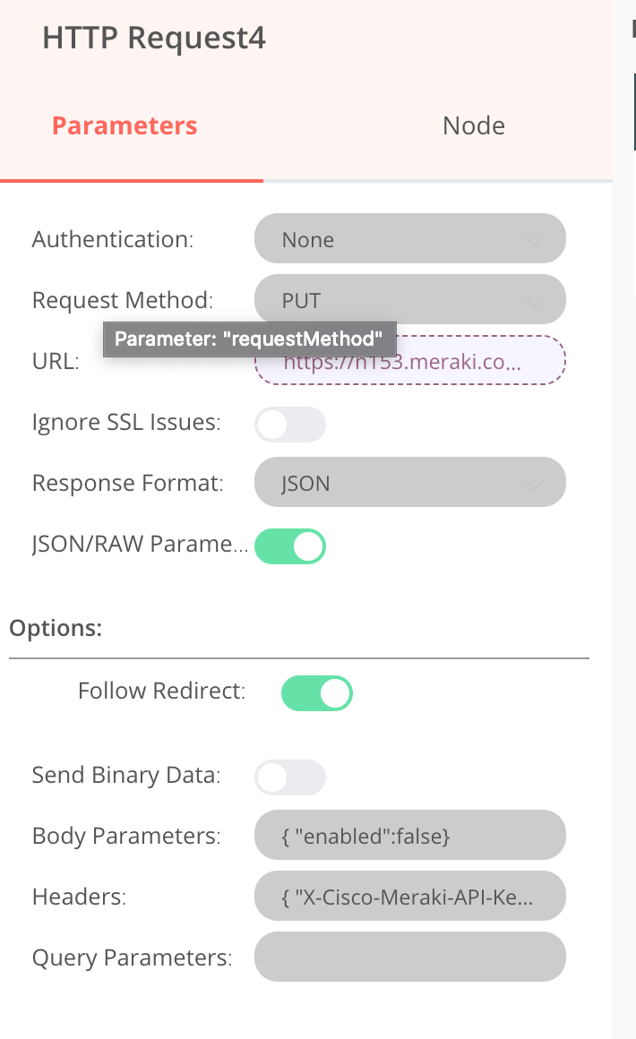

For those interested, find below simple screenshot have working parameters and assigned RAW Body attributes
