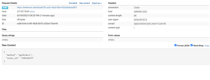

First, check what your flow is actually sending by changing the url to https://webhook.site

Looks to me that it works as you’ve intended. Problem with Integromat is that it doesn’t tell you what is it exactly sending over the wire and you can’t compare it with what n8n is sending.
