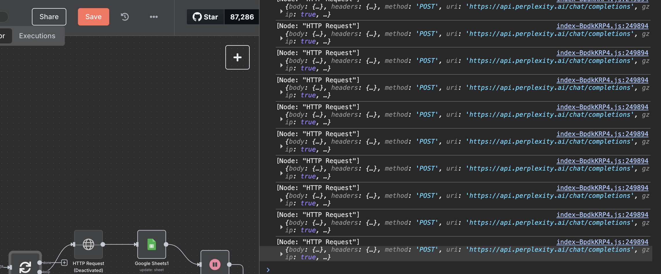

New here - I’m creating an automation to read Google Sheet rows → run each result through Perplexity AI’s API → return result and write output to the associated row’s column in my Google sheet.
However, I’m having trouble with my HTTP Request node. It runs a few times, then gets stuck on the HTTP Request node itself and continuously runs making calls over and over eating my credits (which is why you see the stopped workflow in the image). It looks like Perplexity is returning a valid response (as far as I can tell via the Browser console), yet my loop doesn’t move to the next node. It’s acting as if it’s not receiving a request & re-requesting or something?
Below is an image of my current workflow.

Yes, I’ve tried to run it with it on & off, but the same issue happens. I wouldn’t think it’s falling though since it’s using my Perplexity credits and looks like it’s receiving a response in my browser console. Is that right?

No errors in my browser, just doesn’t move along to the next step for some reason… I tried to do different combinations of batches/wait times to make sure I’m under the limit but no matter what it’s not cooperating.
After running, it got stuck at this point and wasn’t moving along or anything (i.e. updating my spreadsheet)- just continuing to spin on the node. I also tried adding a wait between the http request and google sheet, but that didn’t do anything.

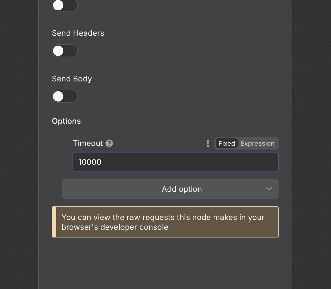

My best guess it the timeout issue
There is a timeout setting in Request node. If you are using perplexty I think there are some operation will take a long time to response.
Then you should consider to set the timeout to super large.
Try to estimated how much it takes now when running python.
Then set +20% or more time in the timeout field.
It’s millisecond so 10000 means 10 seconds.
