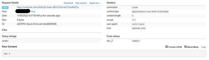

A command like echo "cpu 2" | curl -X POST --data-binary @- http://192.168.14.1:9091/metrics/job/cpu/instance/192.168.1.1 would simply send a body of cpu 2 to the specified URL. From testing this against webhook.site it seems curl infers a content-type of application/x-www-form-urlencoded as well here.
The HTTP Request node below should do the same:
You can verify the results using a service such as webhook.site.

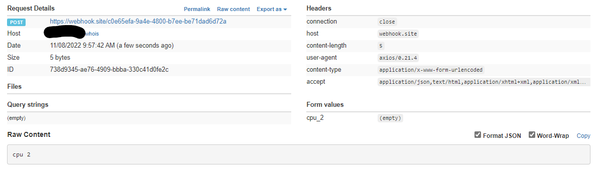

curl command echo "cpu 2" | curl -X POST --data-binary @- https://webhook.site/c0e65efa-9a4e-4800-b7ee-be71dad6d72a:
HTTP Request node:
