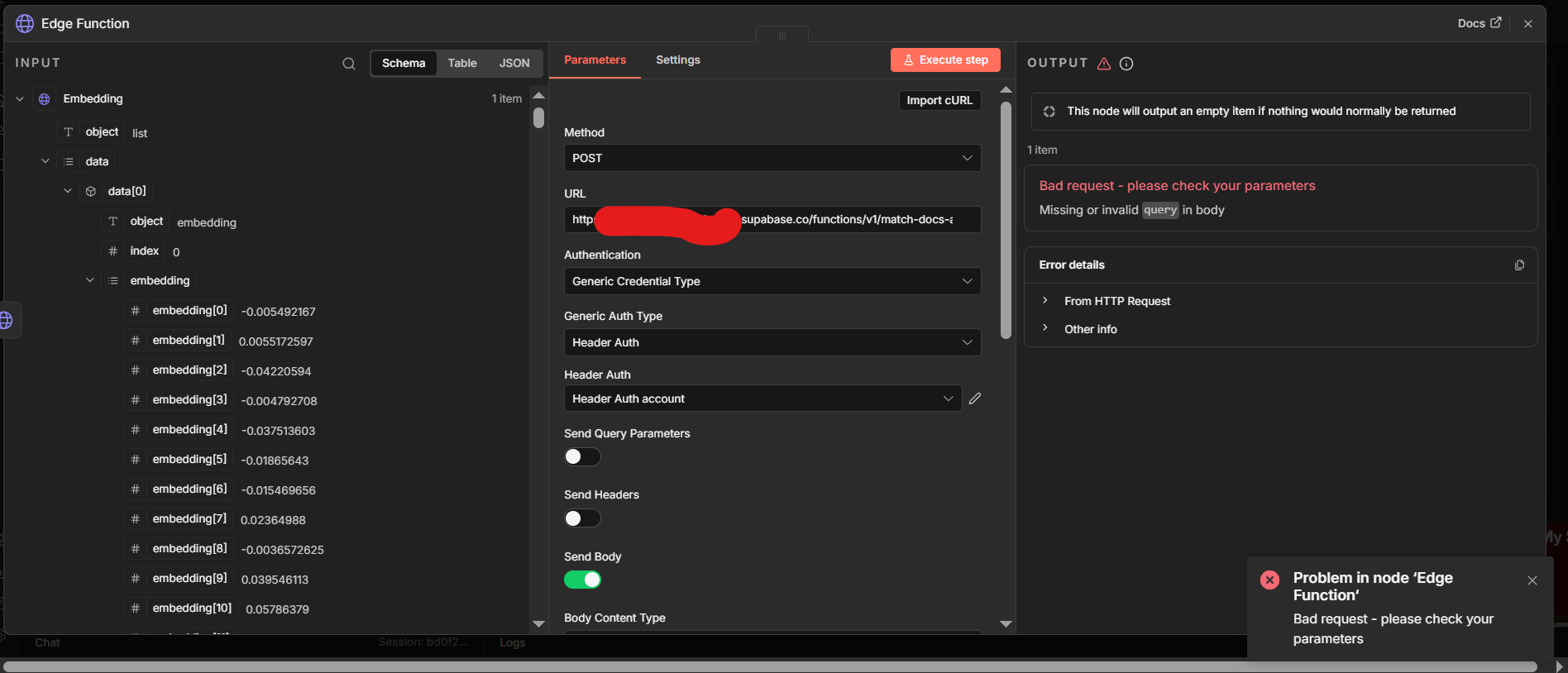

Hey @achamm , thanks for your help.
that error is almost always about the Content-Type header not being set to application/json
This should not be the issue.

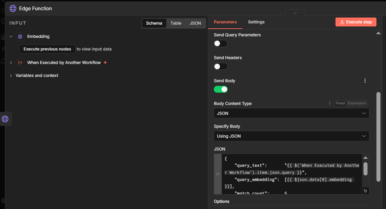

This is my JSON input:
“query_text”: “{{ $(‘When Executed by Another Workflow’).item.json.query }}”,
“query_embedding”: [{{ $json.data[0].embedding }}],
“match_count”: 5,
“full_text_weight”: 1.0,
“semantic_weight”: 1.0,
“rrf_k”: 50
And this is the result → I am not sure if this is correct:
“query_text”: “was muss ich reinigen”,
“query_embedding”: [0.01610721,-0.0033309269,-0.027216487,0.005134019,-0.01871752,-0.0025824734,-0.0068226783,0.039364934,-0.020845354,0.04401648,0.044511326,-0.012160821,0.005941235,0.009463915,0.012445357,0.011610306,0.028107207,0.003383504,-0.054334003,0.06086596,-0.016156696,0.018037107,0.005548452,-0.009092781,-0.033179373,0.0039742254,0.0146103045,-0.04114638,0.043670088,0.0007681699,-0.012129893,-0.036989678,-0.0064886576,-0.019076282,0.02518762,-0.0025762878,-0.006145359,-0.039439164,-0.017109273,0.024024734,-0.010608244,-0.0044845347,0.033327825,-0.042185552,0.024878342,-0.017999994,-0.027612362,0.024148446,-0.00919175,-0.039142255,0.0049979365,-0.015587624,0.024828859,0.06061854,0.032115452,-0.015402057,0.0033958752,0.013410305,-0.0449072,0.051166993,0.01796288,0.0023737105,-0.024680404,0.003596906,-0.043298956,0.016243294,0.019892776,0.058144312,-0.005344328,-0.036197927,0.016985562,-0.011999996,-0.030408237,-0.044065963,-0.043298956,-0.07209895,0.031002052,-0.040008236,-0.0055113384,0.054482456,-0.03075463,-0.029987618,-0.025484528,0.0051494827,-0.0069030905,0.0014126285,0.07971956,-0.0059381425,-0.0076515437,0.0035195865,-0.034094833,0.019101026,-0.0006189431,-0.038820606,-0.0112639135,-0.008919585,-0.013731955,0.00913608,-0.0065938123,0.005839173,0.040997926,-0.084766984,0.016589686,-0.015414428,0.0444371,-0.028923701,-0.050523695,-0.030581433,-0.037286587,0.009630925,-0.012488656,-0.0067051523,0.003213401,-0.012618553,0.013707212,0.010131955,0.015426799,-0.046663903,-0.057649467,-0.05220617,0.037608236,0.030408237,-0.030927826,-0.013521645,-0.027736073,-0.011319584,0.050301015,-0.041690707,-0.0009865976,-0.0071319565,0.015909273,-0.046020605,0.018334014,-0.009210306,-0.030606175,0.033129886,0.039562874,0.059628848,-0.01488247,0.0076020593,0.04772782,0.017294839,0.021080406,-0.024816487,-0.03812782,-0.023715457,0.041195862,-0.0133731915,0.008301028,-0.024482466,-0.03973607,-0.0112268,0.012340202,0.0013724222,-0.037583493,-0.016589686,0.027414424,0.015167005,0.0057494827,-0.0010716491,-0.03216494,-0.003937112,-0.02682061,-0.053938128,0.014065974,-0.0015749995,0.024890713,-0.010311337,-0.00080798945,0.024668034,-0.03785566,0.02649896,0.045575242,0.00920412,-0.041566998,0.009544327,-0.032387618,0.030284526,-0.041690707,0.008319585,-0.008338141,0.020301023,0.013632986,-0.03327834,-0.07190101,0.024581436,0.00095103064,0.030037103,-0.057154622,0.030259784,-0.031892773,0.010496904,0.010045358,0.020338139,0.009686595,-0.011944326,0.014437108,-0.03755875,-0.00039548957,0.012439171,-0.010973193,-0.028082466,-0.0051030912,0.008430925,-0.03350102,0.02101855,-0.043076273,-0.017789684,-0.025979374,-0.023059787,0.04136906,0.012340202,-0.10243296,0.032140195,0.0012185563,0.01905154,0.034639165,-0.025459785,-0.02354226,-0.015352572,-0.0053226785,0.026251538,0.030408237,0.02934432,-0.0025670095,-0.03701442,0.0674474,-0.007806183,0.024383496,0.0009896904,-0.04312576,0.0153896855,-0.035430916,-0.024556693,-0.0117649445,0.04654019,-0.07209895,0.013917522,0.011931955,0.01144948,-0.03733607,-0.0016175252,0.029863907,-0.007886595,-0.0088762855,0.014857727,0.0012641748,0.0095628835,-0.015055665,-0.00012931696,-0.01796288,-0.027315455,0.017270098,-0.024668034,-0.018729892,0.0069340183,-0.02057319,0.024148446,0.042655658,0.009117523,-0.026845353,0.005727833,-0.04522885,-0.06353813,-0.01198144,0.030037103,-0.0018216489,-0.014820614,-0.005344328,-0.03681648,-0.040008236,-0.0218969,-0.006995874,0.0040731947,-0.047999986,-0.0014164944,0.022725767,0.0049824724,0.039142255,-0.00898144,-0.0751175,-0.022812365,0.027513392,0.0027912362,-0.05091957,0.064379364,0.019187622,-0.009934017,0.009123708,0.03592576,0.004663916,-0.011684532,0.0071010287,0.0224536,-0.025657725,-0.030507207,0.0100268,-0.023517517,-0.009816492,-0.016305149,-0.013101026,0.02210721,0.0041164937,0.03285772,-0.026647415,0.021414425,0.06804121,-0.050969057,0.03337731,-0.031595867,-0.015884532,-0.015426799,-0.0013221645,-0.05059792,0.02978968,-0.03392164,-0.012903089,0.022206178,0.039810296,-0.045278337,0.054531943,0.002454123,0.010886595,-0.0024061848,-0.0069402037,0.009408244,-0.010193811,0.024940198,-0.011758759,-0.025855662,-0.014214428,0.0059783487,0.019670097,0.011195873,0.046020605,0.010032986,-0.0036185556,-0.032090712,0.014498964,-0.030160815,-0.0127298925,-0.030284526,0.013632986,0.039884523,-0.033995867,0.04522885,0.02012783,-0.03340205,0.028230919,0.020090716,0.0112639135,0.052503075,-0.0073979357,-0.030235041,-0.010595873,0.05388864,-0.0016298963,0.027711332,-0.022131952,0.0008365977,0.05769895,0.009167007,0.0027170095,0.012173192,0.036470093,0.052701015,-0.0094701,0.028156692,-0.027191743,0.05967833,-0.013781439,-0.027736073,0.026696898,-0.0031608238,-0.048247408,0.0013608243,0.025360817,0.0056319567,-0.02244123,-0.031026794,0.01642886,-0.027191743,-0.026795868,-0.032585558,0.020004118,-0.025039168,-0.009810306,0.020771127,0.020202056,0.0042556687,0.069575235,-0.019534014,0.0420371,0.042952564,0.04423916,-0.007261853,0.017975252,0.06601235,-0.07190101,-0.033971123,0.016057726,-0.0029938135,0.0051092766,0.03295669,-0.030086588,0.03164535,-0.024235044,-0.043744314,0.030680403,-0.06665565,-0.0008791234,0.059183486,0.05591751,0.06764534,-0.00075270596,-0.03456494,0.05121648,0.004577318,0.0016051541,-0.022156693,0.018296901,0.024655662,-0.068189666,-0.028874217,0.041789677,0.013447419,-0.025336074,0.02659793,0.010991749,-0.021315457,-0.053492766,-0.017369067,0.0048402045,-0.018680407,-0.009030925,-0.09144739,-0.021921642,-0.021030921,-0.020511333,-0.019397931,-0.014461851,0.0031438135,-0.0026072157,0.025026796,-0.02704329,-0.0048463903,-0.019830922,0.021513395,-0.031892773,0.003197937,-0.018841231,-0.027958754,-0.014622675,-0.0260536,0.03481236,-0.036173183,-0.012402058,-0.018742261,0.0002853092,0.00015164299,0.008764946,0.03392164,0.0066865957,0.03446597,0.025435043,0.08051132,-0.03491133,0.023517517,0.041764934,-0.05834225,0.0033494835,0.005734019,-0.0052917507,-0.0043855654,-0.037039164,-0.038919576,-0.0047690705,0.013744325,0.007150513,-0.040032975,-0.05482885,-0.062004104,-0.031051537,-0.03285772,-0.0019097932,0.09025977,-0.0401072,0.027513392,-0.092536055,-0.022725767,0.0017922674,0.022861848,-0.041566998,-0.012216491,-0.0060649463,-0.032239165,-0.02266391,-0.014028861,0.007484534,0.00087989663,0.005245359,0.032041226,0.009265976,0.071999975,0.037261844,-0.01991752,0.049632974,-0.007719585,0.030408237,-0.04369483,-0.023715457,0.010428863,0.000085389795,-0.001150515,-0.02232989,0.026647415,-0.0039587617,-0.01895257,-0.009439172,0.03523298,0.023567002,0.014783501,0.032981433,-0.0090123685,0.009705151,-0.030729886,-0.026969064,-0.05878761,-0.016218552,-0.024222672,-0.0077876262,0.00018150767,-0.026672157,-0.00836907,0.0027726796,0.016725767,-0.016923705,0.024358755,-0.0051030912,0.030012362,0.06452782,-0.0038659782,-0.02244123,-0.048024725,0.0396371,0.011758759,0.031447414,-0.013942263,0.0218969,0.021204118,0.026969064,-0.008084534,-0.017789684,0.0055824723,0.039364934,-0.0155752525,0.01937319,-0.004005153,0.026548445,-0.016057726,-0.008870101,-0.011845357,0.03733607,-0.0016252572,-0.027117517,-0.016478345,-0.0133731915,-0.023641229,0.00073298946,-0.019348448,-0.0012719068,-0.02746391,0.0041319574,-0.023022672,0.009123708,0.018309273,0.00023969065,-0.022837106,-0.031595867,-0.011870099,-0.01675051,-0.035109267,0.018136077,-0.012754635,-0.0066804104,-0.009160821,0.05779792,-0.017579377,0.01905154,-0.034119576,0.034762874,-0.011696903,0.031125763,0.0006112111,0.008406183,0.044090707,-0.016094841,0.02289896,0.024148446,-0.007806183,0.027859785,0.014251541,-0.013410305,-0.020585561,0.031892773,0.0015479376,0.028602052,0.008356699,0.008059791,0.03110102,0.00040244832,0.011511336,0.032387618,-0.0049855653,-0.0060030906,-0.0028175248,-0.011375254,-0.010620615,0.003955669,0.008727833,-0.0062257713,-0.009364946,0.030828856,-0.007874224,0.0030402052,0.009655667,-0.03525772,-0.023059787,-0.036519576,0.027092775,-0.031274218,-0.00527938,0.04520411,-0.019571127,0.018222675,0.034861844,0.04391751,-0.0034762875,-0.0023737105,-0.005403091,0.017987624,-0.032981433,0.03874638,-0.0051556686,0.04752988,0.0569072,0.01992989,0.01795051,-0.0037701018,-0.027785558,-0.04819792,0.0067051523,0.0022855662,-0.010311337,0.016701026,0.04357112,0.006071132,0.0159835,-0.029839166,-0.028156692,0.044065963,-0.0014876284,0.015859788,0.01905154,-0.00094948424,-0.021402055,0.0028824734,-0.031670094,-0.02232989,0.029319579,0.056461837,0.01631752,0.027686588,-0.01489484,0.05131545,-0.011665976,0.0046113385,-0.019199993,0.0018448448,0.0040175244,-0.009098967,-0.01981855,-0.018989684,0.019002056,-0.018259788,-0.010762883,0.0078185545,-0.02112989,-0.019039169,0.048420604,-0.023925766,-0.039909266,0.0033216483,0.024470095,0.03921648,0.06051957,-0.0150680365,0.0020381436,-0.0006792524,-0.015451541,-0.029294835,-0.017208243,-0.021080406,-0.043298956,0.028750505,0.014202057,0.040008236,0.029022671,0.02289896,0.002916494,0.019620612,0.034688648,-0.009550513,-0.021661848,-0.0048958748,-0.007954637,0.021204118,0.0036618544,0.023232982,-0.002636597,0.0023103086,-0.012228862,0.019150509,-0.04641648,0.037385553,-0.0200536,-0.030729886,0.0024788652,-0.026375249,0.0031670092,0.0116288625,-0.033179373,-0.0027293805,0.025212362,0.0008999997,0.017121645,0.01850721,-0.00023969065,-0.004298968,-0.04587215,-0.031002052,-0.0074721626,0.014065974,0.00539072,-0.046441223,-0.025385559,0.05948039,0.035752565,-0.025558755,0.0043175244,-0.0120865945,0.009043296,-0.019880407,0.0047814418,0.0019469066,-0.037682462,-0.013199996,0.007855668,0.0063525755,-0.022305148,0.009606183,0.048123695,-0.0023999992,0.015476284,-0.0030185557,0.005347421,-0.012890718,0.0053010294,0.02012783,-0.025806177,0.016045356,-0.025435043,0.017542262,-0.023938136,0.0032319578,-0.023876281,-0.010478348,-0.015884532,-0.035381433,-0.00034329886,-0.031694837,0.008041235,0.0051494827,0.02407422,-0.019348448,-0.041962873,0.011202058,0.030284526,0.027760815,-0.03491133,-0.0003187499,-0.024692776,0.033971123,-0.0027262878,-0.010045358,-0.0080969045,0.010323708,0.09317935,0.014498964,-0.004527834,-0.005434019,-0.03602473,-0.008239172,0.019323705,0.021538137,-0.026523704,0.028107207,-0.00020257726,-0.005362885,-0.006544328,0.05383916,0.02210721,-0.017752571,0.0284536,-0.006995874,0.016181437,0.027167002,-0.032189682,0.039265968,-0.037459783,-0.0005918812,-0.04062679,-0.022960817,0.00022403343,0.0071999975,-0.005941235,-0.000106894295,-0.0019036076,0.0037329884,-0.040552564,-0.019645354,-0.015797934,-0.014065974,0.007255668,-0.001581185,0.0021061848,-0.009129894,-0.007478348,-0.031620607,-0.03424329,-0.03461442,-0.02912164,0.029022671,-0.0066865957,-0.019546386,0.006884534,-0.002418556,-0.027340198,0.020350508,0.022144323,-0.018556695,0.009247419,0.017232984,-0.02179793,0.005304122,0.0042123697,0.04696081,0.019360818,0.00095798937,0.0025067,-0.039711326,0.04334844,0.0018092778,-0.050301015,0.005427833,-0.027315455,-0.025929889,-0.017171128,-0.0001764819,-0.044610295,-0.0075340183,0.0026969064,0.008468038,-0.008127833,0.024692776,0.022206178,0.010509275,0.020486591,0.013076285,-0.025459785,-0.0021618549,-0.00071597914,-0.014387624,-0.020548446,-0.026226796,-0.043942254,-0.017059788,0.0075835027,-0.010769068,0.013039171,-0.028725764,0.015946386,0.018544324,-0.014177315,0.014004119,-0.020721642,0.012556697,0.019558756,0.018136077,-0.0042556687,-0.036074214,-0.00082268013,0.0007631441,0.018482469,-0.019694839,0.0066742245,0.017096901,0.006556699,-0.029517516,-0.02299793,0.04421442,0.016503088,-0.01324948,-0.029962877,0.023802055,-0.0064886576,-0.007138142,0.010632986,-0.006779379,0.021179374,-0.020498963,0.006482472,0.0010422677,-0.025039168,0.055373177,-0.005619586,-0.0038566997,0.03446597,0.014140202,-0.012111336,0.030061847,-0.026870094,-0.028404115,0.018012365,0.00012264815,0.0028484527,0.027315455,-0.018668035,-0.01871752,-0.004651545,0.011232986,-0.04389277,0.0027432982,-0.020399993,0.005245359,-0.019435044,0.005062885,-0.008059791,-0.028824734,0.017604118,0.013558758,-0.027389681,0.0033587618,-0.034193803,-0.017393809,-0.025101023,0.019002056,-0.008146389,-0.000089207446,0.010373193,-0.008307214,-0.02232989,0.01555051,0.0024881435,0.044313386,-0.010292781,-0.055323694,0.02924535,-0.010608244,0.030012362,-0.040280398,0.0076577296,-0.034169063,0.024841229,0.003609277,0.0141525725,-0.010453605,0.014189686,0.015847418,0.0014296387,0.0124268,-0.0106639145,0.06343915,0.00061237096,0.0024371126,0.027315455,0.043175243,-0.03456494,-0.020622674,-0.039265968,-0.028503083,0.032387618,-0.026969064,0.03065566,0.01882886,-0.006773194,0.003995875,-0.01960824,-0.0114432955,0.02748865,-0.0044845347,0.025830919,-0.0004948452,0.010521646,-0.023294838,0.016564943,-0.025558755,0.010144327,-0.023059787,0.0039865966,0.03775669,0.031472154,0.011938141,-0.019979374,-0.019744324,-0.0035938132,0.026474219,0.03461442,0.0035103082,0.010045358,0.033105142,-0.035059784,0.016441232,-0.018259788,0.025657725,0.0080041215,0.0356536,0.03456494,-0.014585562,-0.00134768,0.005242266,0.027983496,0.014647418,-0.0066927816,0.024531951,0.0021201025,-0.0041412357,-0.016911335,-0.0063773175,0.0116721615,0.0278103,0.013496903,-0.017146386,-0.033550505,0.0030572156,0.008134018,-0.015847418,0.037608236,-0.015934015,0.0050566993,0.029072156,0.014721645,0.015909273,0.029913392,-0.005718555,0.002802061,-0.015946386,0.009940203,-0.023690714,-0.016292779,-0.008802059,0.00084432965,0.0014605665,-0.0072865956,-0.017492779,-0.028379371,-0.04020617,0.028552568,-0.01347216,-0.008764946,-0.009661852,0.0033061844,0.025781436,-0.0077010286,-0.018197933,-0.0040298956,-0.04127009,0.009692781,-0.0131876245,0.015228861,0.010329894,0.030061847,-0.015018552,0.0073113376,0.017505148,0.010793811,0.0058515444,-0.026375249,-0.024395868,-0.004710308,0.02124123,0.016589686,0.027760815,-0.0035103082,0.0013237109,0.021810303,0.010521646,0.003797937,0.02790927,0.0001583118,0.0059783487,0.01347216,-0.026622672,-0.019496901,-0.0014002572,0.012692779,-0.0052701016,0.003454638,0.009674224,0.0073917503,0.053344313,0.0036958752,-0.025880404,-0.007750513,-0.0019082468,0.013670099,0.017010303,0.0027262878,-0.026399992,0.0022824735,0.0009572162,-0.008115461,-0.036841225,-0.0038505143,-0.016824737,-0.007367008,-0.006921647,-0.008152574,0.014387624,-0.04290308,-0.013162882,0.012340202,0.06601235,-0.011257729,0.0010043811,-0.014399995,0.018445354,-0.01927422,-0.008053605,-0.018841231,0.019422675,-0.0038072153,-0.008307214,0.0065072146,-0.0020768035,0.0040577305,0.006668039,0.083579354,-0.013051542,-0.01368247,-0.021204118,-0.016342264,-0.0020164943,-0.0046113385,0.0037298957,0.020103086,0.016020613,-0.020090716,0.044857718,-0.01576082,0.003596906,-0.025459785,-0.01728247,-0.024383496,-0.008882471,-0.0128659755,0.0068350495,-0.042779367,0.01105979,-0.020498963,-0.02988865,-0.022206178,-0.021080406,-0.010329894,0.011232986,0.055373177,0.006253606,0.03622267,-0.0068288636,-0.028329888,0.027340198,0.013125769,-0.0011273192,0.039439164,0.015896901,-0.012705151,-0.040676277,0.020486591,0.0056072148,-0.0013268037,0.025781436,0.014164944,0.022020612,-0.017814428,0.04960823,0.0024077313,-0.01730721,0.01673814,0.02046185,0.008430925,-0.010917522,-0.008127833,-0.050870087,0.007422678,0.0027340197,0.02758762,0.004521648,-0.039983492,-0.017678345,0.0028237104,-0.005059792,-0.027637104,0.010911337,-0.021748446,-0.007663915,0.01895257,-0.041665968,-0.0052206167,-0.009822677,0.009828863,0.03154638,-0.0027773187,0.04050308,0.013261852,-0.019002056,0.022676282,-0.035480402,0.0053226785,-0.00041365967,-0.014338139,-0.0026056692,0.019039169,-0.009018553,0.0060092765,0.039166998,0.0046268026,-0.0032381434,-0.023195868,0.028107207,-0.005087627,-0.012334017,0.020437106,-0.00063556683,-0.015847418,-0.002130927,0.028651537,-0.012977315,0.014090717,-0.0092907185,0.0056103077,-0.0016747417,-0.0062659774,0.023703085,-0.026177311,0.019397931,-0.007478348,0.031397928,0.03785566,-0.019026797,0.008820616,-0.028008237,-0.038053595,-0.05091957,0.025558755,-0.03832576,0.017369067,-0.0058237095,0.010936079,-0.009785564,0.020041231,0.02375257,-0.033872154,-0.04849483,0.012569068,0.016391747,0.027439166,0.007973193,0.016713398,-0.011505151,0.017492779,0.015018552,-0.017876282,-0.010645357,0.010329894,-0.013237109,-0.004636081,-0.02889896,0.035480402,0.022193808,0.037929885,0.029938135,0.014338139,0.013261852,-0.017146386,0.0030494835,-0.016503088,0.030606175,0.016465975,0.0019097932,-0.0032350505,0.009111337,0.008437111,0.021092776,-0.0039494834,0.013125769,0.010670099,0.0046113385,-0.011468038,-0.0149319535,0.0030572156,0.0034855658,0.028008237,0.0025005147,-0.019632984,0.0025577312,-0.018049479,-0.010849481,-0.008597936,0.02464329,0.0061917505,0.034639165,-0.012154635,0.02464329,-0.0015819583,0.010855666,0.025880404,0.014597934,0.051711325,0.020647416,-0.035010297,0.018593809,0.012030924,-0.023195868,-0.020140199,-0.0066618538,0.02704329,-0.017220613,0.03337731,-0.021748446,0.0010298965,0.019336076,0.040428855,0.014585562,0.014004119,-0.002959793,-0.0009672677,-0.010367007,-0.010212367,-0.044164933,-0.0019175252,-0.0062257713,0.0011451027,0.010051543,-0.035752565,-0.02231752,-0.0025175249,0.027241228,-0.01631752,0.004821648,-0.020387622,0.026103085,0.023468034,0.00024626282,-0.0073051522,0.004184535,0.00838144,-0.009457729,-0.05230514,-0.053146373,-0.033550505,-0.029047413,-0.028156692,-0.013917522,-0.030630918,-0.038597926,0.029740196,-0.008022678,0.041096892,-0.0036340195,-0.004892782,-0.015154635,0.0011721646,0.047777303,-0.025051538,0.0102989655,-0.05923297,0.024828859,-0.0034886587,0.02649896,0.017393809,-0.0019778344,-0.022404116,-0.016243294,-0.01345979,-0.0009989687,-0.025756693,0.024012363,0.03951339,0.010799997,0.010595873,0.031249475,-0.047851533,-0.01840824,0.007484534,-0.025336074,0.021364942,-0.0230969,0.018074222,0.049979366,-0.00017155278,-0.00213402,-0.02276288,-0.037632976,-0.013360821,0.016280407,0.021080406,-0.020276282,-0.0004430411,-0.03822679,-0.032115452,-0.018098963,-0.003482473,0.0178268,-0.0039865966,0.013014429,0.017356696,-0.0038566997,-0.00095953577,0.021154633,0.011777316,-0.030853597,0.008171132,-0.00036088907,0.018754633,0.010317522,0.015265974,0.0043329885,-0.004963916,0.015463913,-0.014808242,0.038795862,-0.0016824737,-0.007268039,-0.0473072,-0.015340202,-0.018148448,-0.037731946,0.045154624,-0.025979374,0.0073484513,-0.00892577,0.02790927,0.0050010295,-0.0070886575,-0.01673814,0.020659788,0.03285772,-0.009346388,-0.01860618,0.028973186,-0.024692776,-0.012841233,0.042284522,0.00025844065,-0.010540203,0.014115459,-0.0073113376,0.0012889171,0.032090712,0.021179374,0.008084534,-0.0776907,-0.016688654,-0.04127009,-0.03194226,0.01707216,0.004382473,-0.017789684,-0.012340202,-0.04124535,0.011301028,-0.0060061836,-0.02244123,-0.0171835,-0.0039432975,-0.022960817,-0.017715458,-0.0029860814,-0.00079948426,-0.008010306,-0.016305149,-0.012538141,0.0037762874,0.018482469,-0.00044884006,0.016329892,-0.018964943,-0.018865973,0.0048030913,0.0066371113,-0.0063525755,-0.002616494,0.0035814422,0.021958755,-0.019187622,-0.046688646,0.027414424,-0.031026794,0.004939174,-0.02464329,-0.0009626286,-0.021859787,0.021488653,-0.0051835035,-0.020523705,-0.0058979364,0.0092412345,-0.016812366,-0.008437111,-0.0024092775,-0.037088647,-0.0038721636,-0.0070453584,0.029369062,0.0007631441,-0.005384534,0.010113399,0.039018545,0.0044567,-0.0019561849,-0.0029458753,0.04136906,-0.0015695872,0.01100412,-0.025707208,0.016577315],
“match_count”: 5,
“rrf_k”: 50
double check it’s actually an object with a query key or whatever your edge function expects.
How exactly do I check this?
