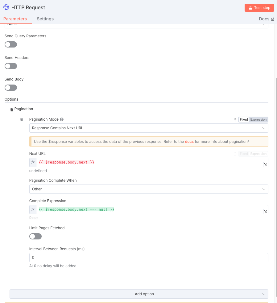

Have you tried to use the pagination feature of the HTTP node?
Easy to implement and easy to use.
Here is a small example with the pokeapi.
To help you with it, please share the HTTP response. It would be best to “pin” the data in the HTTP node (using the pin icon in the top right corner) and then post the workflow or the node as a comment.

i try pagination but idk what parameter to use (offset not working)
https://redmine.server/users.json?limit=3&offset={{ $json.offset }}

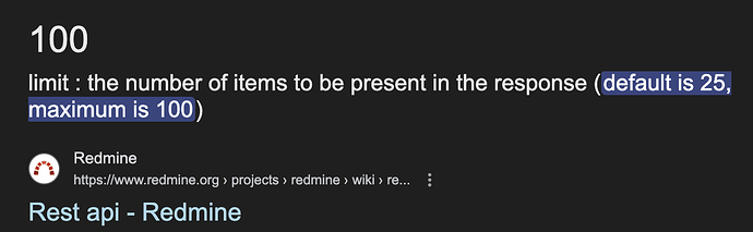

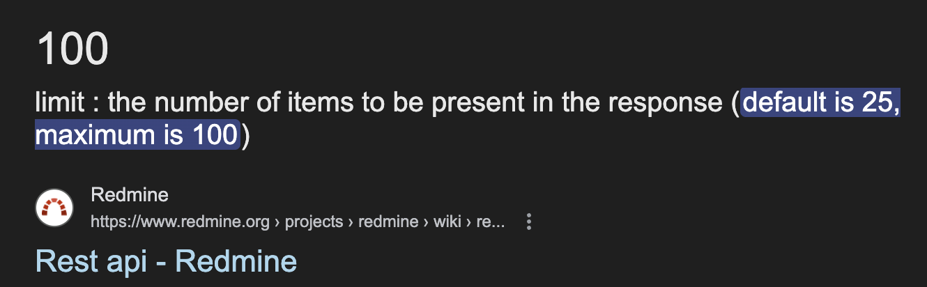

Yes the hard limit is 100.
Can not just set to 10000.
