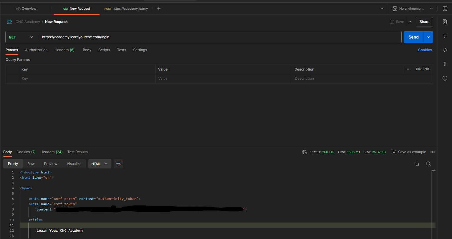

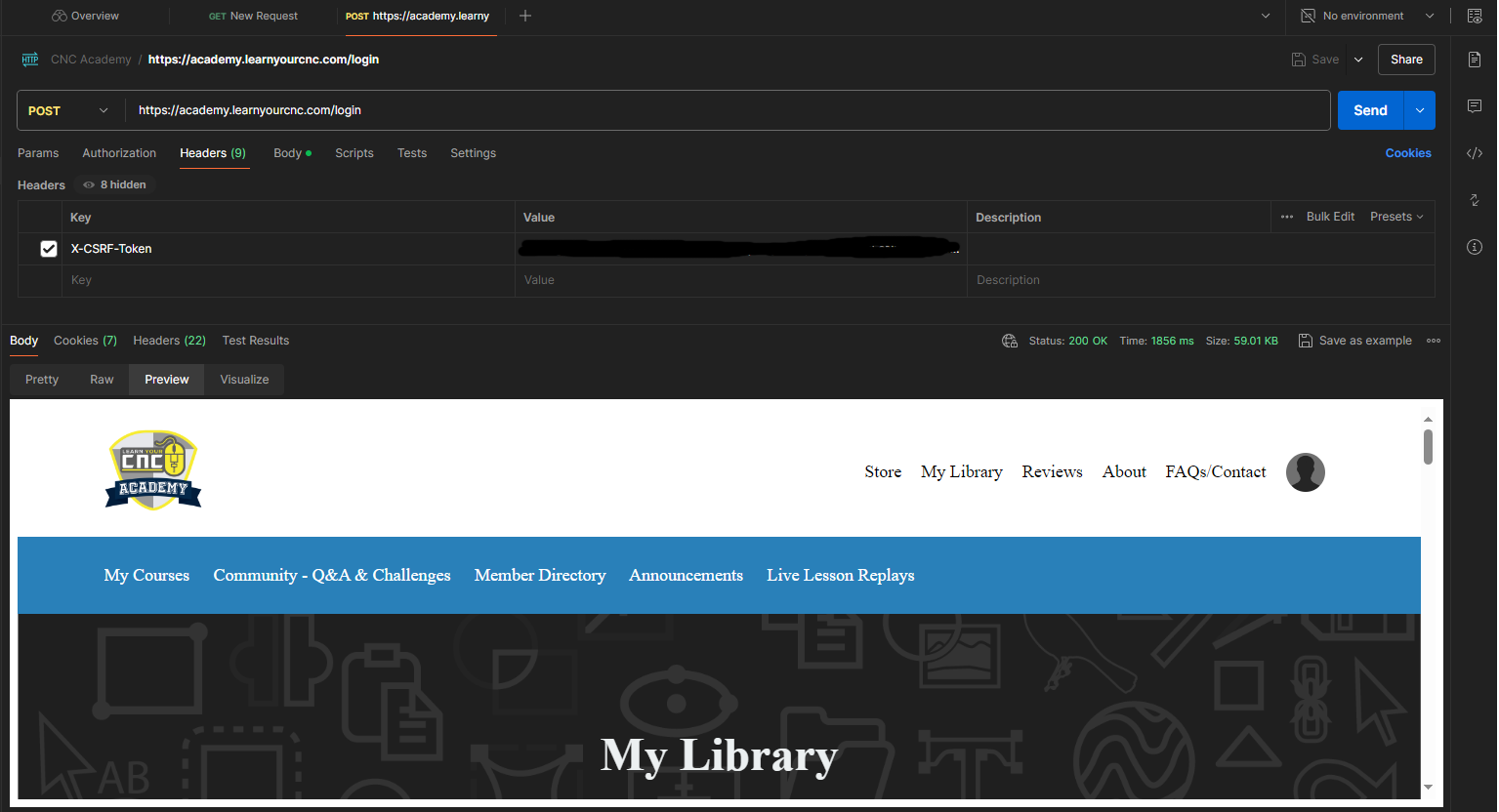

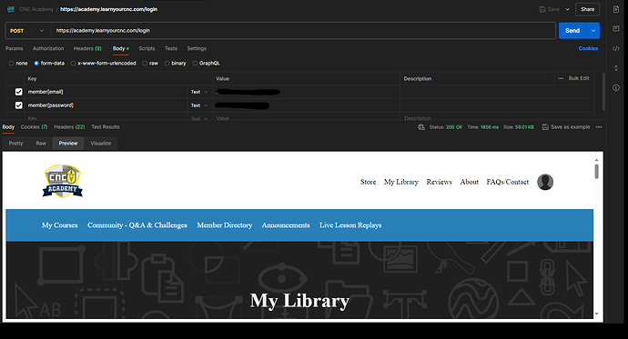

@mariana-na After trying Phind, it suggested I use Postman. I then tried accessing the site there. After creating a GET call, I got the CSRF token. I then used that in the POST call with my username and password. I was able to get logged into the site.

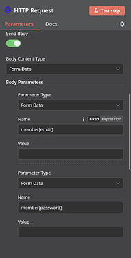

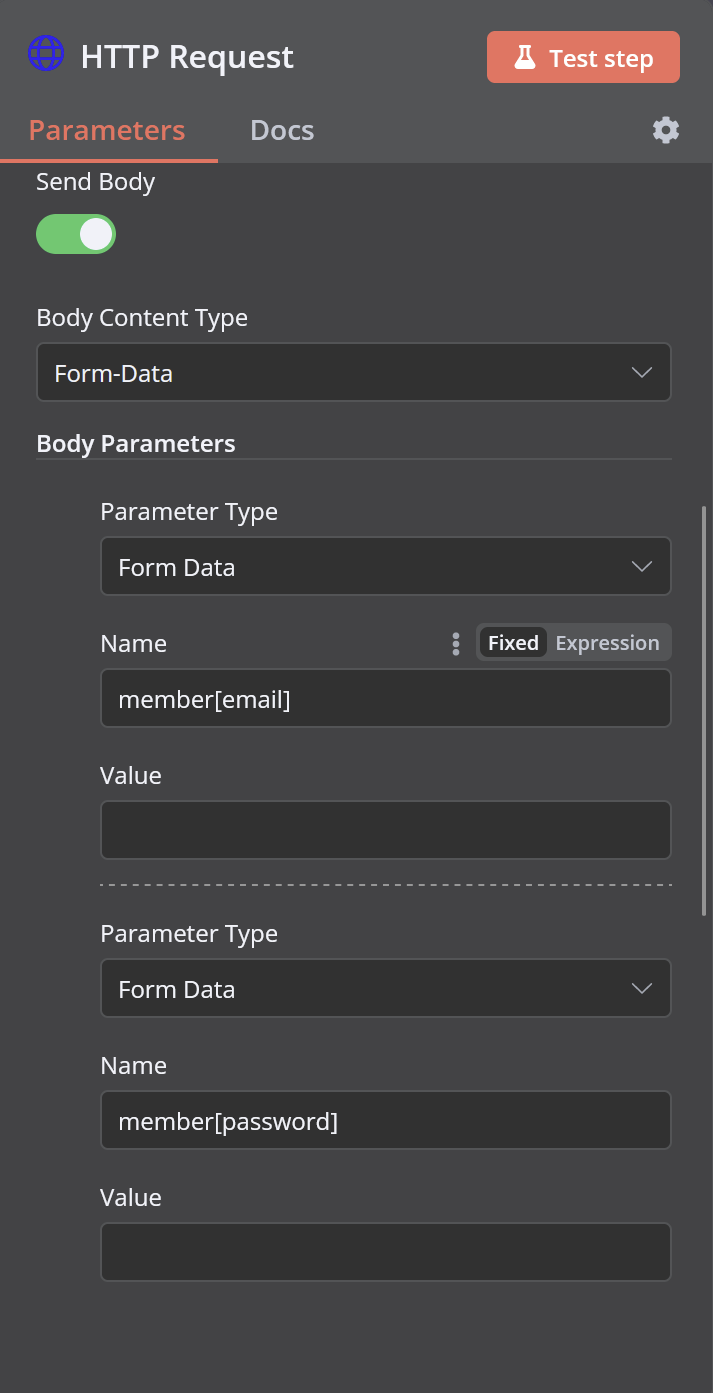

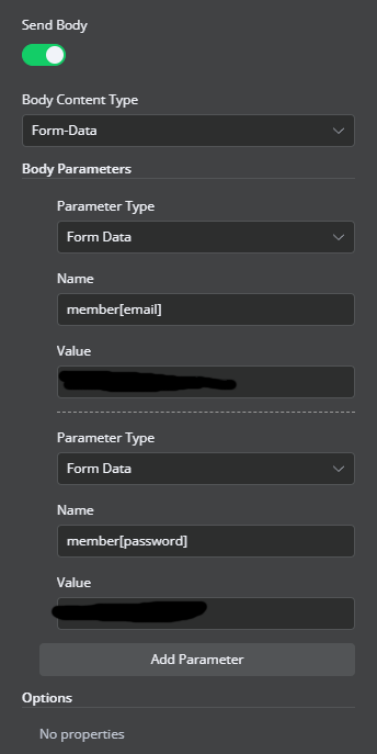

So using those details in my HTTP nodes, I still can’t get in. I am getting a 422 error. Here are a couple of screenshots from Postman and my Nodes. Maybe you can see something I did wrong.
Postman GET
Postman POST
Header
Body
n8n POST node
So I made some progress in figuring this out, but now I can’t figure out why n8n doesn’t work when I used the exact same info in Postman and it let me log in.
I still haven’t been able to figure this out. Postman seems to get and store the cookie, but I can’t figure out how to get the cookie in n8n. I keep getting a 422 error. I have googled this but I am not coming up with anything. Does anyone have any ideas on how to make this work?
