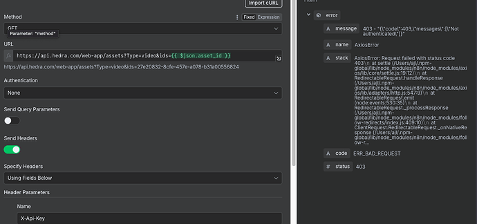

i have been trying to use the HTTPS node with the GET function to receive the video i have made with hedra so i can automate an upload to tiktok.
but each time i get error code 403.
i talked both with hedra customer service as well as tried with GPT but nothing has worked.
anyone have any ide how to fix this?
i have tried both the custome autherization as well as every single x-api-key lowercase and uppercase possible
as well as the autherization header with the bearer “api key”
if anyone has any insights please do share

you need to check the status of the “Generation.” Once the status is “complete,” you will receive the Asset URL.
should be something like this.

Hey Franz,
YOU ARE AMAZING!!!
thank you so much for the help!
it helped me a lot to finally get it done. i really appreciate the assitance.
