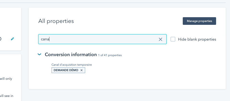

Is that a custom field? If so, go to contact:create/update and under additional fields, you can find the custom fields.
What you are showing me in the picture it’s the properties the operation will return.

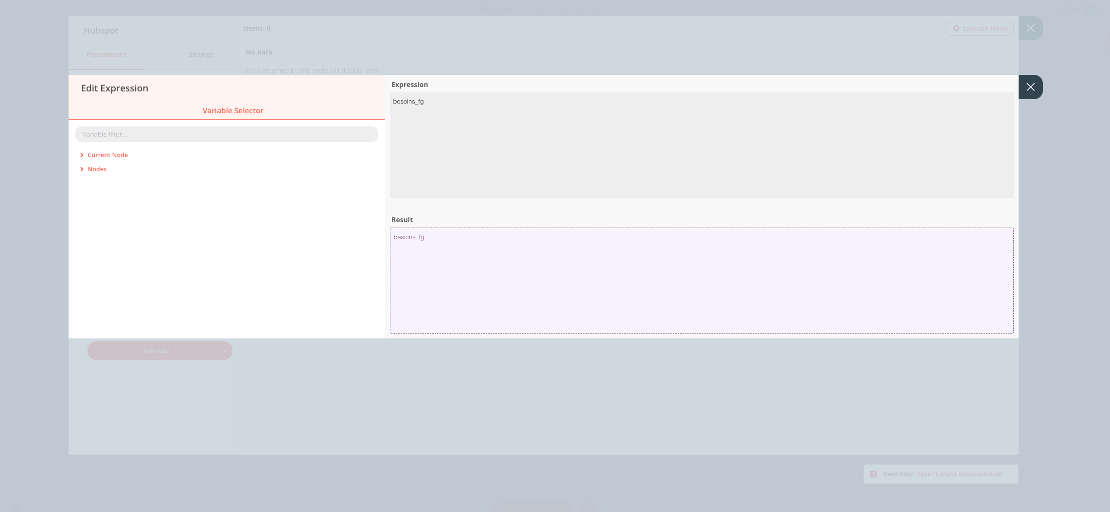

  6. As I want to enter a value for the custom field “Besoins FG” I click on “Add Expression”
  7. In expressions, it’s written besoins_fg
  8. I don’t what to do to specify a value for besoins_fg
  9. “Besoins FG” is a multiple checkboxes field type on Hubspot. Possible values are “Pic”, “100%”, and “distance”
  10. I should rewrite expression like this {{ {besoins_fg: ‘Pic’} }} or something like this ?

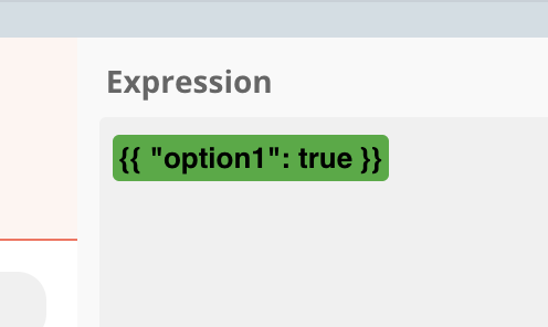

To answer your question. Assuming that the option you want to select is called ‘option1’ then the expression has to be set as {{ "option1": true }}

Oooooh, I have selected “Properties”, but I should had selected rather “Custom Properties”, right ?
What is “Properties” for ?
Thanks for your help
Yes, correct. Properties it’s to set all the fields that the API will return once the operation is executed.
It worked !! Thank you very much for your help. The question is resolved :wink:
