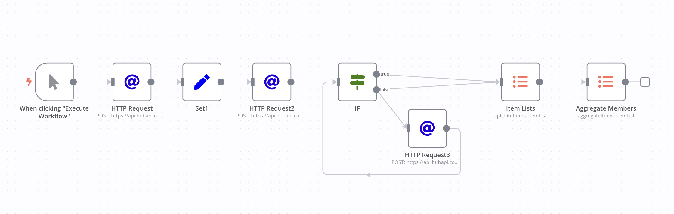

@MutedJam and I worked this out using Hubspot’s pagination in their API:
That might work better for you! This is using the paging.next.after option in their API :slight_smile:
@EmeraldHerald & @MutedJam amazing amazing!!
99.9% but I figured out how to get it to 100% - Your code had the JSON as “operator”: “NEQ” this was causing an infinite loop, I changed it to “operator”: “EQ” and now I am getting the exact output needed.

The API splits it into 6 runs, so the item list has 1 of 6, 2 of 6, etc… Is there a way to merge the 6 into 1?
Hi @madhatter349 - Did a little editing of that code node from the example I linked you earlier, this workflow should do exactly what you’re looking for:
Let me know if that helps!
This is AMAZING, thank you so much for you help!!!
